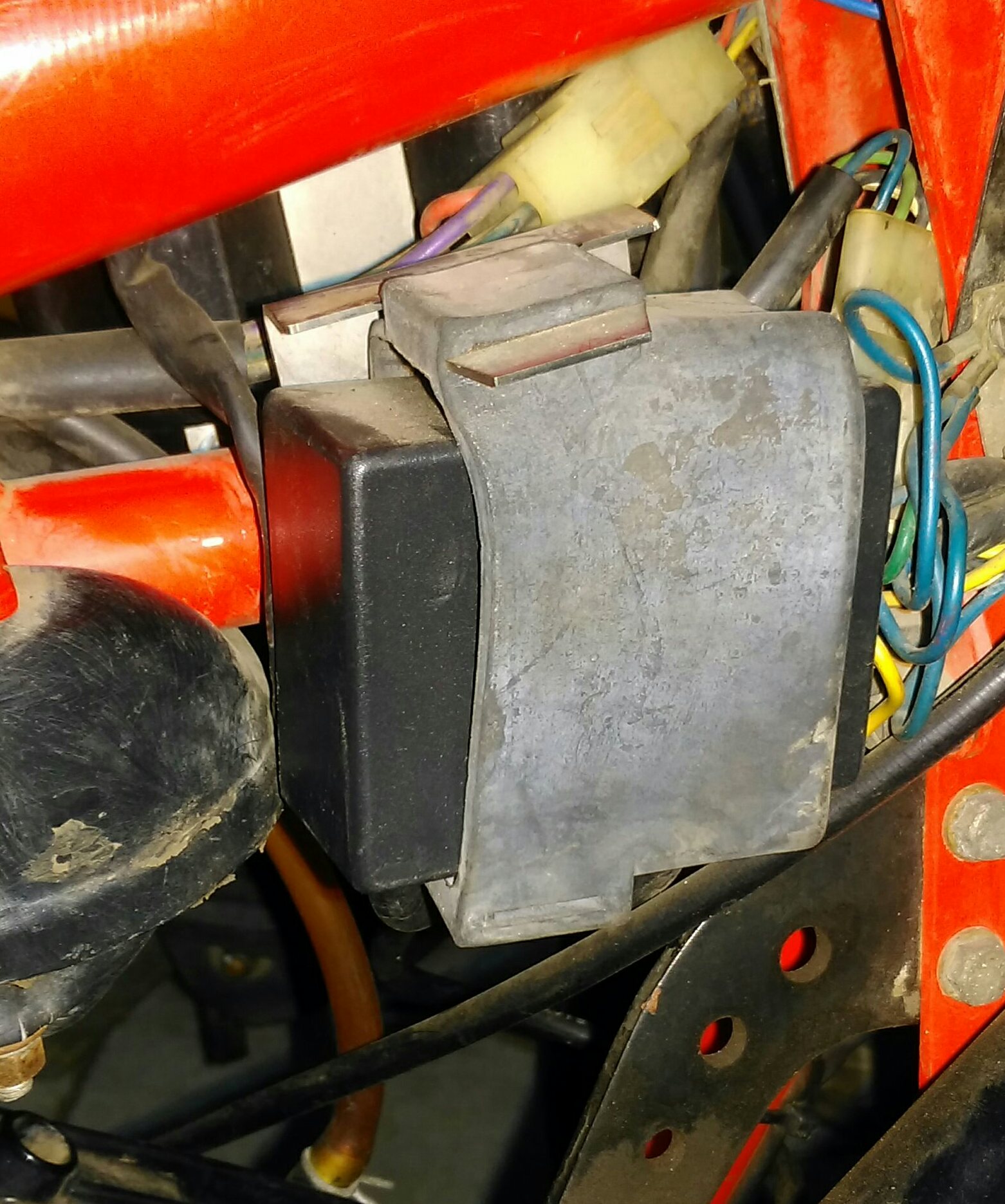

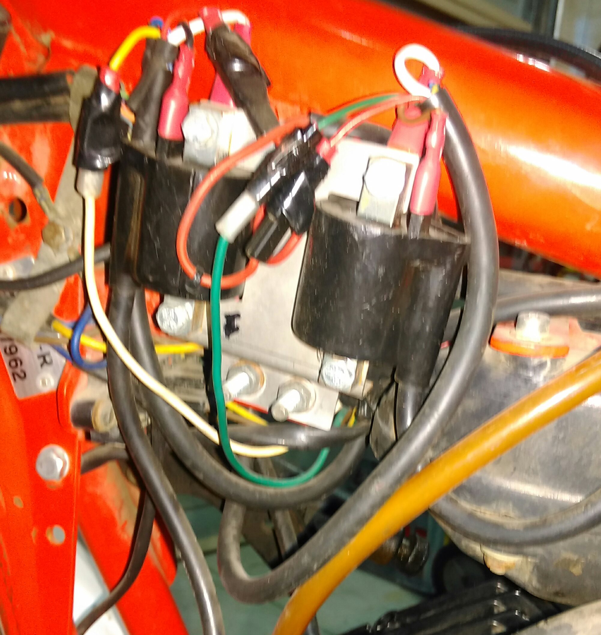

Will try to post pics of coils and transducers. Do these look like original or updated ?
- IMAG3501_1.jpg (501.63 KiB) Viewed 11512 times
Transducers.

- IMAG3498_1_1.jpg (410.03 KiB) Viewed 11511 times

Aha!, those are the replacement transducer/cdi from NLM (North Leicester Motorcycles) and the ones I have on my 350 Sport. I think they are an improvement on the originals. Especially if the originals are busted. NLM recently sold up to Mdina Italia (you may already know this, sorry!) and I would hope that Mdina continue the kits. Mainly because they are one of the few replacements that run with out a battery, as the original Morini/Ducati system.
Thanks Steve, that is reassuring.
