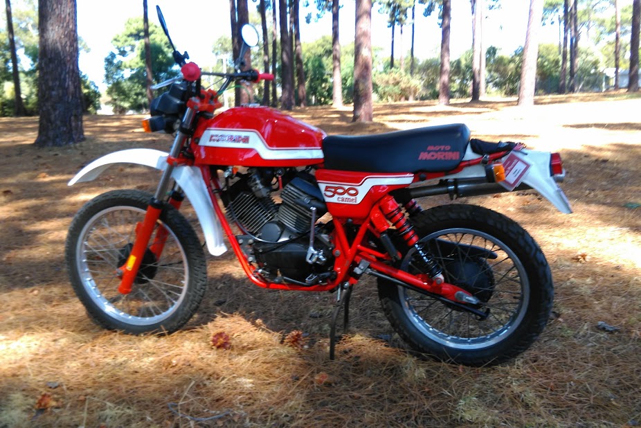

New to me mk1 Camel in OZ.
Update,
Even though the bike looks quite good, I have been going through it fixing many small things.
Fuel tank fiberglass leak fixed.
Engine oil renewed. Valves adjusted.
Carbs cleaned and kits fitted. New fuel lines.
New plugs fitted. It had BP6ES in it. I have read it should have 8`s. So I put BP8ES in it. Old plugs were running black. Quite sooty.
Rear wheel bearings fitted. Chain cleaned, re lubed. Rear brake serviced.
Swingarm lubed.
Gearchange shafts and linkages lubed.
Center stand rubbers reinstalled. Side stand rubber installed. They no longer hit each other when up.
New front guard fitted.
Still to do.
Front wheel/brake overhaul.
Steering head bearings overhaul.
Bike runs nice except just off idle when getting back on the power there is a bit of a cough/splutter before she runs clean again. In the shed it revs up nice. Mixture screw 1 1/2 turns out. Carbs balanced using mercury sticks. I did forgot to check float level when carbs were apart. Plug leads look original. Not sure if either one of these may be causing the sputter.
Throttle is a bit stiff. Cleaned out the throttle housing. I am wondering if the springs in the carbs cant be replaced with a set a bit softer. I know they need to have enough spring to return slide from high RPM. But I might get a set made 20% softer and see.
All in all, its nice to ride. Real happy.

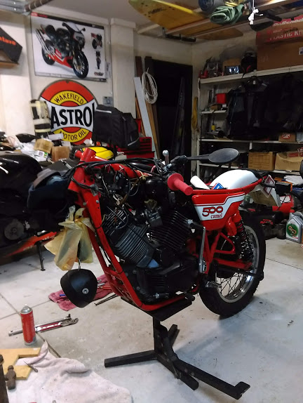

Worked tonight till I had enough. Front end off, forks feel like there is little oil in them, front brake has near new shoes but wasn't adjusted right.
I took off top triple clamp and thought with a little persuasion the head stem would tap down out of the top bearing. I was only using a rubber mallet, but it wasn't moving.
Am I missing something here ? I get that the bearings are in retainers that are pressed into the top and bottom of the head tube (frame). But shouldn't the head stem tap down and out ?
Cheers.

Those taper bearings are often very tight on the stem. Every one I've done has been anyway. I can't see any need for them to be so tight so I eased the stem down with a little wet and dry when I fitted the new bearings. They could also be corroded in place as well of course. As you're replacing the bearings I would try a bit of heat on the inner race.

Got the bearings out, thanks. Just cleaned everything up, top bearing in, tomorrow morning will put the bottom one in (in freezer now) Might use the hairdryer on the frame first. Top one was a tight fit.
While everything is out, I might replace the fork oil.

Got head stem bearings on. Tomorrow going to get some O rings to help seal the dust cap to retainer. There was 1 in the top when I disassembled. Im thinking there should be one top and bottom.

Hi Ross, there is only an O ring on the bottom and it is much easier to fit if you put it over the bearing retainer on to the frame and pull it down in position after you have fitted the yokes/stem to the frame.
As it mostly sits towards the outside to fill the gap you can also fit a slightly thicker and tighter O Ring if you wish, which helps to keep out the dirt and water.
And look after it; pull it back up to clean and lubricate it.
Trust this helps, Ian

Thanks Ian,
I thought the O ring was on the top. But thinking about it, it probably was on the bottom. I have sourced a thin one that fits nicely on the top. So there is less chance of crap entering now. I also relieved the stem a little so the top bearing slides on with less effort.
Thats all for today.
Cheers.
Tomorrow I hope to drain the forks. I hope clean oil comes out !!
