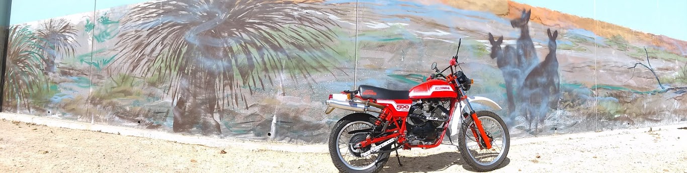

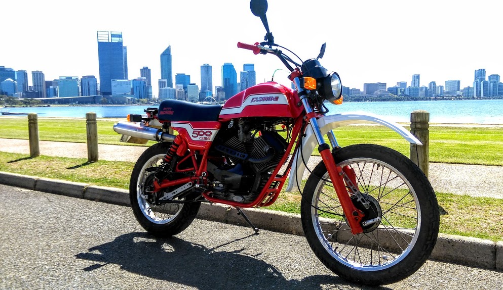

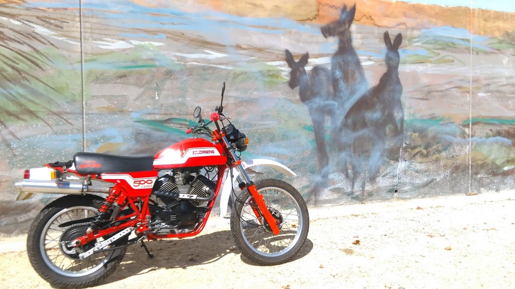

Some pics from yesterday putting some kms on it before I go into the real bush.
