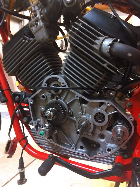

So I have opened it up. It all looks good so when I get time I will start to fit the seals I got from Mdina (great postage. 1 week to Australia)
I think the leak was because there was no sealant between the clutch shaft and the slide on spacer.
No problem. New seals all through.
I will have to find some Hylamo or whatever it is they recommend.
More pics tomorrow.

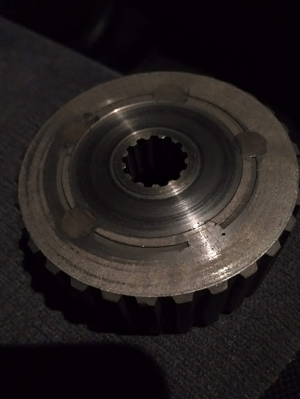

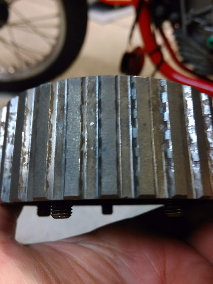

A thing of beauty !
Dressed the rough spots down. Not too bad for 18000 kms.

I have put all the seals in and tightened up the side case. But when I tighten up the clutch hub nut, I get no end play or free play at the clutch basket. It is running tight on the plastic shim.
When I pulled it apart, there was no metal shim along with the plastic shim.
It is part number 24 in the parts diagram.
If anyone has this shim handy, could you measure it ? I think it's 22mm id and aprox 28 od. But I don't know the thickness. If I can get measurements, hopefully I can get one here instead of Italy.
Or if anyone knows where to find the directions on how to set end float, I would appreciate it.

Bike is back together and runs nice.
On reflection;
I probably did the clutch hub nut up a bit tight. I backed it off and then did it up to about 10nm. The metal shim is not there but the back of the hub has been worn where it was rubbing on the plastic thrust washer. So Im not sure if I need the metal shim at all.
Clutch is working fine. A bit hard to get into N but otherwise its good.
