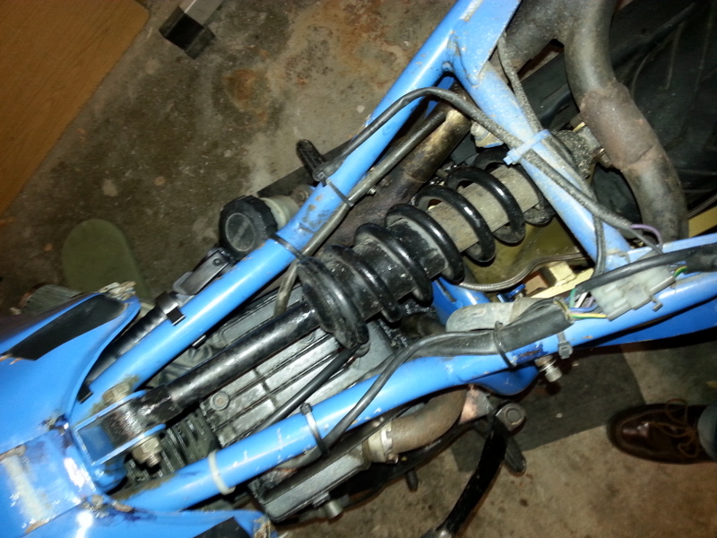

Here's an alternative..
I've recently bought a x3 Kanguro with a supermono conversion, I removed the seat the other day to find this.
I've never seen an x3 shock before but this looks suspiciously like a BMW item from a r65/80/100. It's 410 mm long 390 mm between centres which seems a bit long to me.
Can anyone supply me with the correct centres, bolt hole to bolt hole? There is very little damping left and it has a habit of pogoing off the throttle which is quite annoying.
