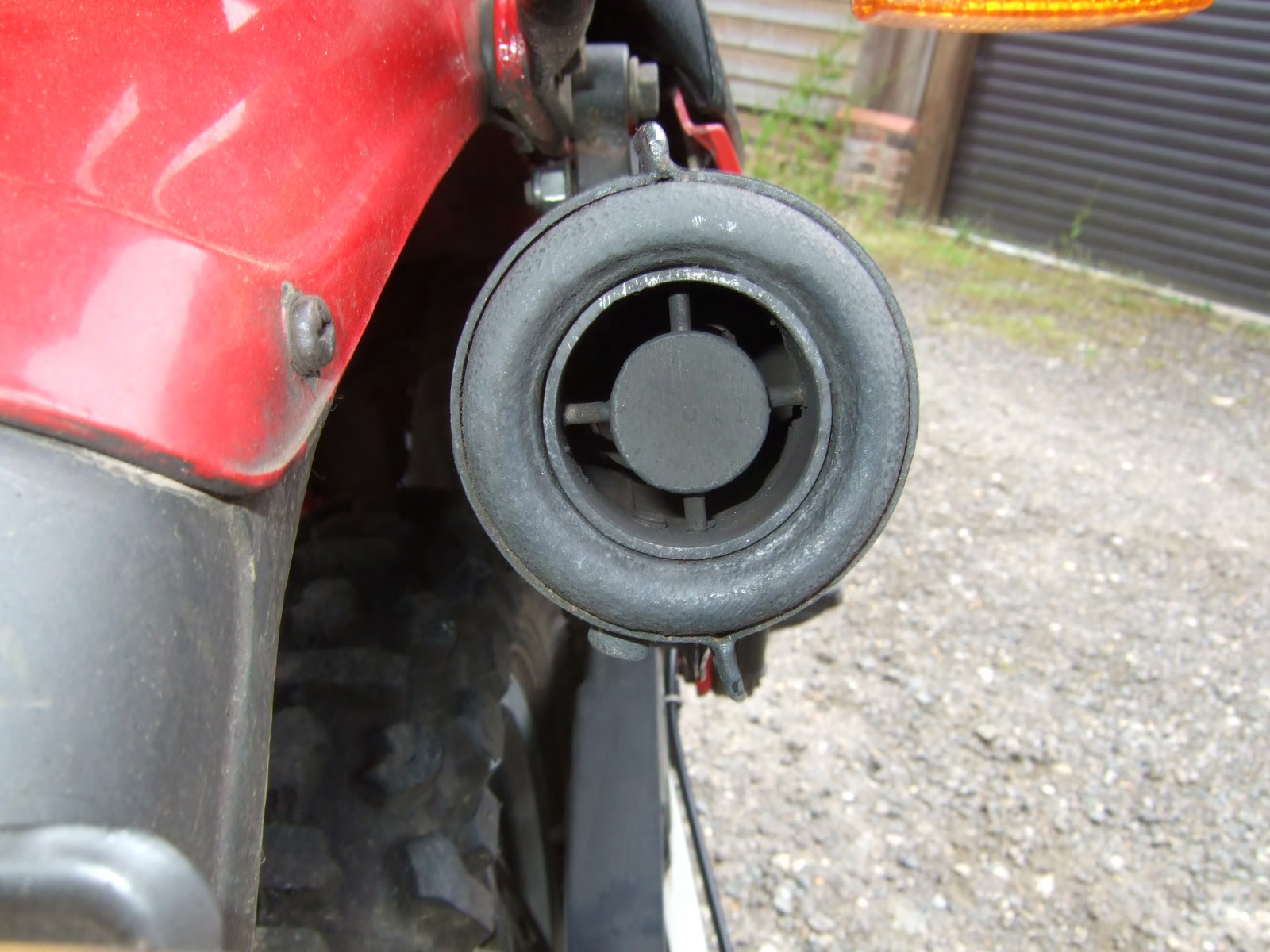

Many thanks for the photo of your MM62 - I also modified my silencer and it is a bit quieter now - I put a circular disc in front of the inner pipe and supported it with 4 radial webs, photo attached. Although non standard, the bark has been subdued to a more acceptable level.
