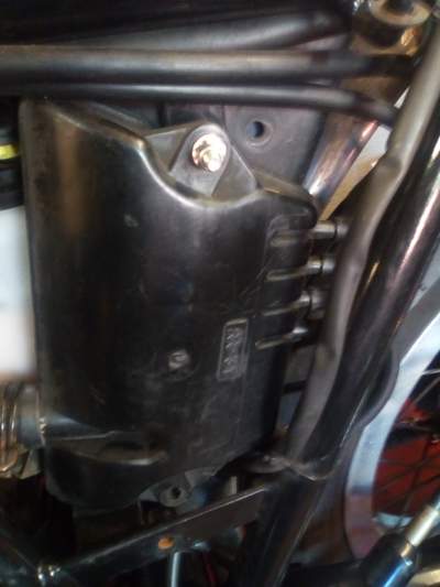

I do have another question though folks, I re-fitted the original plastic breather catch 'tank' once I worked out where it fitted.
The tank has a big fitting at the bottom which I've connected to the engine crankcase but it's the four upper vents I wanted to ask about. I've fitted two of the pipes to the two cylinder head breathers and then run pipes from the other two fittings to vent to atmosphere at the bottom of the frame. Is that right? and is there meant to be an order to the four connections as I couldn't tell if there's a difference?

Re: Newbie Camel owner saying hi!
Posted: 22 Oct 2018 13:30
by MickeyMoto
Hi Jamie,
I believe there is an order, as the internal box is baffled. I'll have a look at my breather box later. Mine vents to fresh air, but I believe some bikes had spigots on the top of the air filter boxes so the fumes, oil mist or whatever was burnt in the engine to reduce emissions.
Posted: 22 Oct 2018 19:08
by MickeyMoto
Hopefully this is the box you are talking about...
MM31?
Top two from the rocker boxes, bottom two vent, in my case to the chain for a bit of lubrication (hopefully, or not?).
Posted: 22 Oct 2018 20:23
by 'It must be a .....'
Hi, looking at a Mk1 Camel breather box from the back of the bike: the 2 left pipes go to the rocker covers and the two right pipes go to atmosphere or in some cases to the airbox.
Like Mike I have the pipes leading to the chain (near the front sprocket).
Originally on the UK Mk1 the airbox pipes were simply attached to the top tube where they went to atmosphere and covered everything under the tank with a film of oil.
Enjoy
Posted: 23 Oct 2018 07:56
by fofs216
HI Guys,
That's brilliant thank you!
Incidentally my breather box is mounted across the frame with the four small outlets pointing directly upwards and the large outlet at the bottom!
Jamie
Posted: 23 Oct 2018 08:30
by MickeyMoto
fofs216 wrote:HI Guys,
Jamie
Hi Jamie,
Mine is not a standard bike. It is an early Strada with a later engine, so I placed the box under the left cover. On the Excalibur it was also horizontal behind the engine.
Mike.
Posted: 23 Oct 2018 10:43
by Ming
None of the Morinis I have run have had breather boxes. All the pipes vent to atmosphere and I've never (touch wood) had any problem with oil fouling.
Posted: 23 Oct 2018 11:02
by MickeyMoto
Hi Ming,
Without the box I would need the fat tube with baffles to keep crankcase pressure. This tube looks ugly hanging out the back. I had a bad experience on a 500 in hot weather. On a long journey on the A1 came to a roundabout and applied the brakes. Back did not work, disc was covered in oil from the breather. Just a fine mist, but friction was absent... Also lost the kick start, but that is another story!
