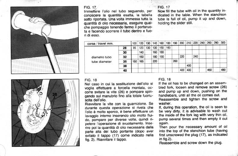

I have later 501 brake disc forks fitted to my mk1 Camel, the forks have gold sliders with 40mm tubes and 380 stamped upon them.
One of the seals is leaking, very badly! When I stripped the forks down yesterday both tubes/stanchions came out easily and despite having what appears to be a 10-15mm lower bushing indentation no lower bushes were actually present. Does anybody know if lower bushes were actually fitted to the later 501 Marzocchi forks?
Also, one of the legs (the leaky one) held 250ml of oil whilst the other held 450ml. Does anybody have any information as to how much oil or level from the top measurement please?
I have the Marzocchi manual titled Forcella Piffero which contains details for earlier 32,35 and 38 mm drum forks which gives some confusing information on oil levels and doesn't appear to show a lower bush....
Many many thanks in advance,
Jamie

Hi, I've never taken a set of these forks apart; but the non electric start 501 Camel has 40mm forks with no bushes and the 501 Coguaro has 40mm forks with bushes.
So it sounds like the 501 electric start has forks similar to the Coguaro?
There are parts books and handbooks on the Italian club site.
480 ml in each fork leg.
From the 501 Camel (electric start) handbook; 'fill each stem with 480 gr. Castrol TQF or equivalent'
Have fun, Ian

'It must be a .....' wrote:.
To be pedantic - the specific gravity of Castrol TQ: I Density @ 15C, Relative ASTM D4052 g/ml 0.865
So 480 gr will be more like 555 ml I think? Or to be on the safe side actually weigh an empty jug in grams then fill until you get jug weight + 480 grams.

When I had my first Camel and no access to any data I measured the oil that came out of the fork legs which was 330 ml.
A couple of years later I got an original MK 1 Camel handbook where it states 333 gr per fork leg; so you can see the logic/error.
Yet having filled several Morini forks (road bikes as well as Camels) over the years and always measuring what comes out has only reinforced this incorrect conclusion.
Although the 333 ml is not critical in terms of lubrication; I will experiment with the oil quantities in the future, measuring the levels from the top of the fork which makes it much easier to alter the oil/air volumes.
Again thanks, Ian

MK 1 Camel handbook states 333 gr per fork leg Castrol TQF
Once filled take the weight off the forks so they are fully extended before closing the small Allen air bleed screws in the fork caps; they need the volume of air inside to function properly.
Enjoy your Camel
