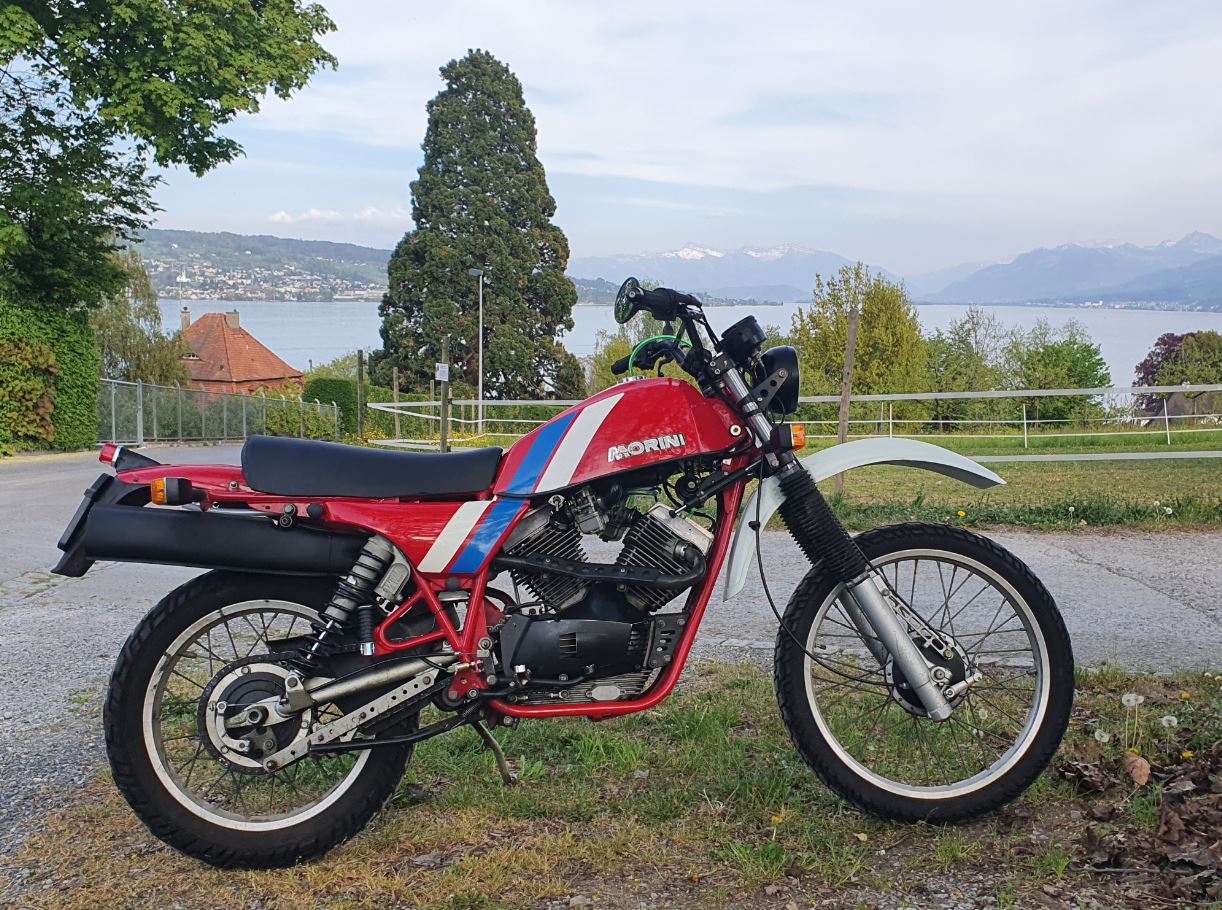

This is my recently completed Camel Mk2 (well I think it's a Mk2)....
First run out..JPG (281.32 KiB) Viewed 10565 times
First run out.1.JPG (377.46 KiB) Viewed 10565 times
Kamel

Hello Kamel!
Your bike is quite lovely..... My bike should be ready for the road today! I will take plenty of photos....fingers crossed. Ben

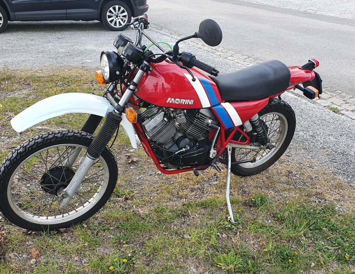

Here is my bike!
ImageIMG_20200905_152837_390 by staticvoid1975, on Flickr
Ben

Posted: 06 Sep 2020 19:44
by Steve Brown
Nice!

Posted: 06 Sep 2020 22:27
by Kamel
Very nice Ben !
That a steel tank?
Re: Camel woodruff key
Posted: 07 Sep 2020 02:50
by forzamacchi
Thank you! Yes, it is a steel tank... Ben
