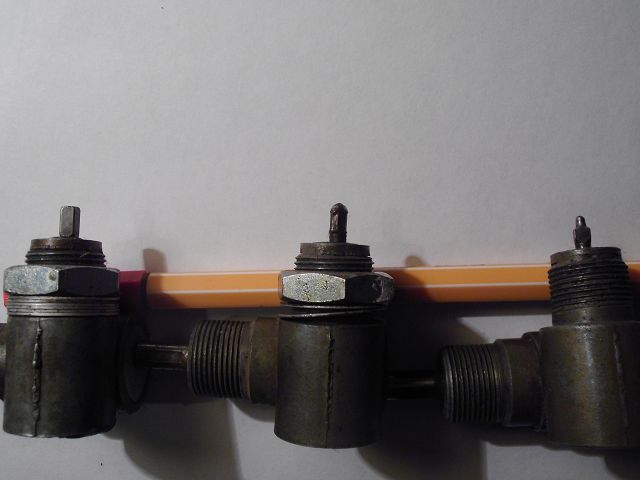

How it should be, how problems begin and how it ends: It´s very important to distance the drive properly with the distance washers. As far as posible into the nut with the sqare hole, but with a little clearence left.

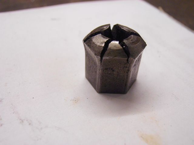

The nuts can end like this: This one was obviously mounted without the special washer. To avoid that problem I use the special washer plus on top a usual washer (I´ve had that problem, not that brutal, also using the special washer) If you fix the nut on the camshaft it can be blasted from the inside
These nuts don´t need to be fixed with much tourque. I stop when I begin to turn the motor fixing it with a spanner.
Also I use to grind a little bit the beginning of the drilling of the rotor to make it a bit easier to get it out again. As you only can take of the rotor via the pickup, sometimes there ist the problem of a stuck rotor.

Thanks Norbet! There's a story in those pictures!norbert wrote: ↑16 Jan 2023 16:39 They are not easy to find![]()
