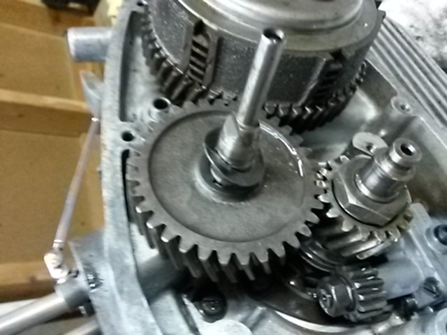

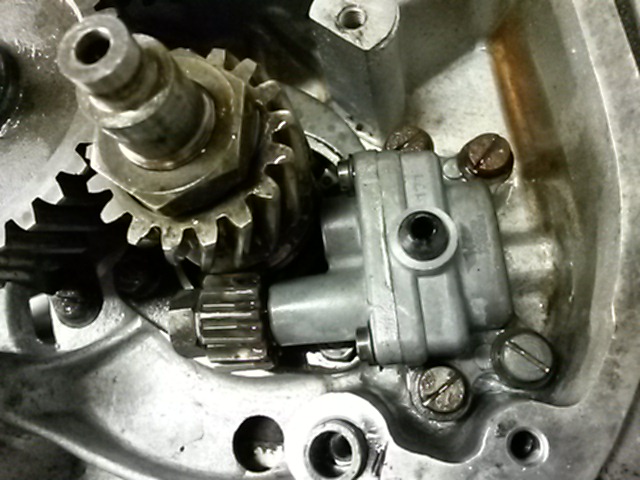

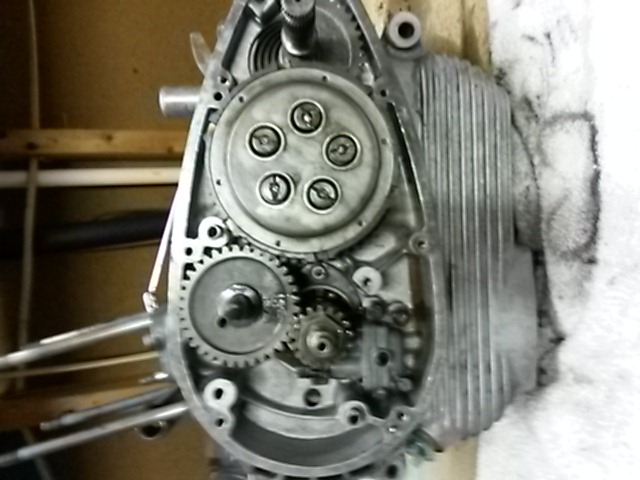

I started the motor tear down last night. Its slow going with the impact screw driver. I removed the bearing support plate and started on the clutch springs. Two of the spring bolts broke off and a third is stripped. I can uncrew the button but it just spins. Anyone seen this before? Not sure how to get it out and its the last bolt. Maybe drill a hole in the middle where I can get a screwdriver in to hold the bolt while unscrewing the button? BTW the NLM clutch button tool works perfectly on this motor. Hope you can tell by the pictures that the design is very similar to the Morini 3 and 1/2.

A few pics of the tear down
