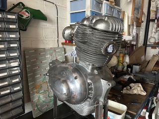

So, this is how far I’ve got into the project. I have all but finished the assembly of the engine thanks to purchasing the other two basket cases from Nichola for Donor arts and the magnificent Arthur Farrow who has supplied some very hard to get bits including a generator. He has also provided a very sensible Benjy Straw mod for the sump plate which I carried out which enables the use of a 14mm magnetic sump plug which makes an oil change far less messy. To complete the engine rebuild, I am just waiting for the M7 x 85 mm waisted bolt that holds the rotor and automatic advance and retard mechanism on to the crankshaft to be made (another hard to obtain part).
As the 19 inch wheels supplied with my purchase had no brake plates, I purchased some used replacements from BEB Recambi in Italy along with some other parts not with the bike and the two basket cases. I managed to find a replacement NOS headlight reflector from the US for $29 plus shipping ($24) which is an absolute bargain compared to the over inflated scabby badly abused offerings from Italia. I have installed the swinging arm into the frame, installed head-races and the top and bottom yokes and the top fork shrouds to the bottom fork yoke (a bit of a faff) and have put new fork seals into the forks and re-built them. A point to note: when removing and re installing the cap head screws that hold the dampers into the bottom of the fork legs you must use a pneumatic or electric rattle gun to do so. Also it is wise to purchase a seal driving kit (mine came from Amazon at £15.00) to make seating the new seals correctly and trouble free. The seal size is 30mm (ID) x 40 mm(OD) x 7mm and readily available. The frame is starting to resemble a proper motorcycle frame and not just a collection of newly painted parts. To be continued …….

Just thought I’d post an update on the progress so far. I managed to purchase an NOS headlight reflector at a very reasonable price and a couple of weeks later managed to get an NOS Rolle Speedometer drive and a NOS voltage regulator from the same chap in the US. His prices were considerably cheaper than Italian vendors wanting over inflated prices for used parts in not very good condition. I now have the engine complete and awaiting marriage with the frame which will happen when I get my wheels rebuilt. I have gone down the route of purchasing Stainless rims and spokes from Devon Rim Company who are making custom rims and spokes at roughly half the cost of having the original rims re chromed before adding the cost of spokes and nipples into the mix. I intend to rebuild the wheels myself. I have now assembled the forks into the frame which caused a lot of bad language to be uttered, but they look good. I shall post a further update when I get the wheels finished and fitted.
