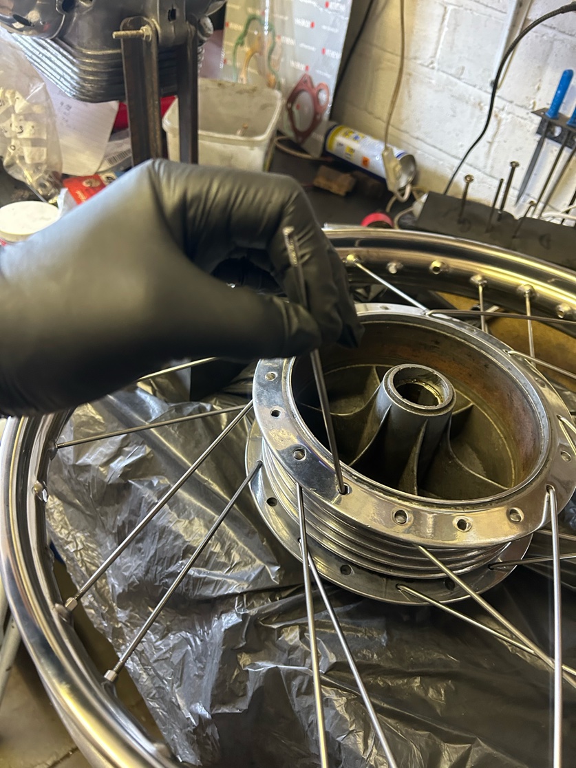

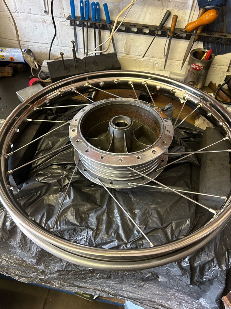

Update as to progress:
I entered the arcane art of wheel building and very much to my surprise I found it relaxing and therapeutic. Trust me, it s not as daunting as it seems, this is where YouTube can be your friend. I also invested in a trueing jig made by Laser Tools which was fairly inexpensive and a god addition to my tool kit. As soon as I get some shocks back from NJB, I can tun it into a rolling chassis, meanwhile, I’ll turn the frame upside down and attach the centre stand.

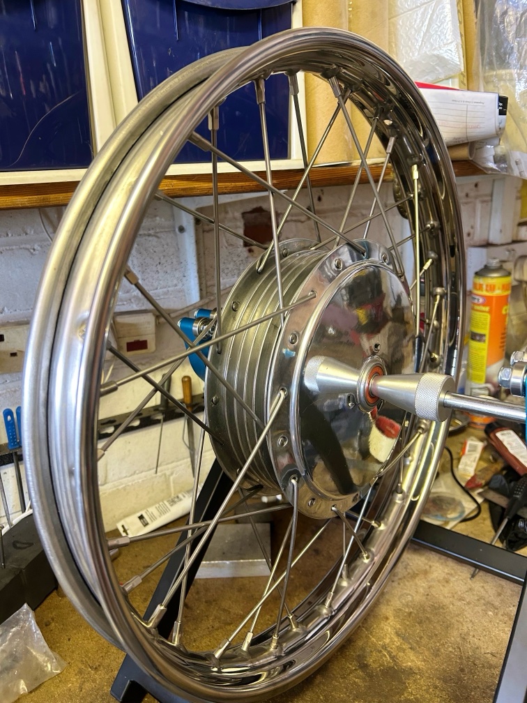

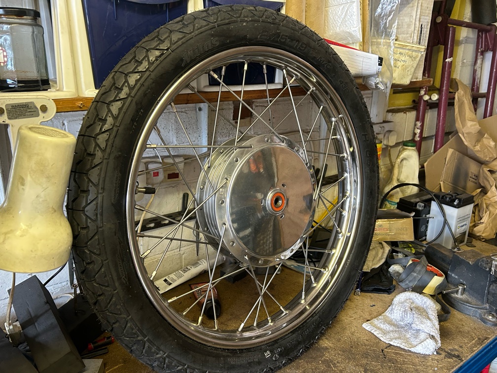

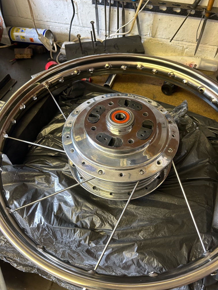

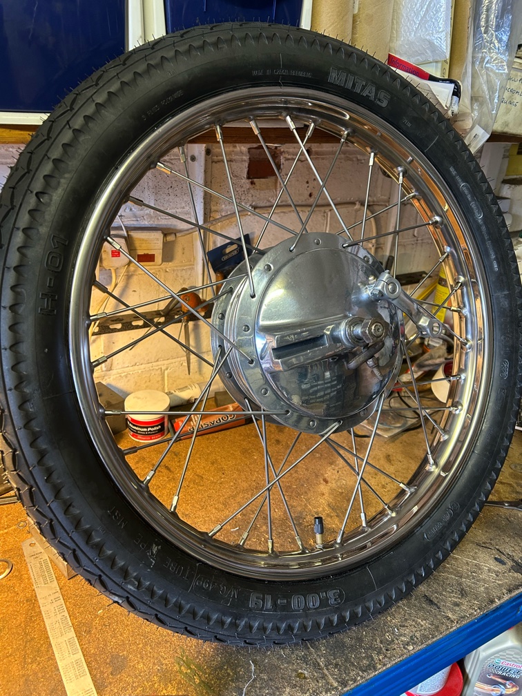

I draw the line at ironing! Here are some pictures of my efforts.

Re: New to Tresette
The finished product

Your wheels look superb, Neil.
For a first attempt I'd say you've nailed it!

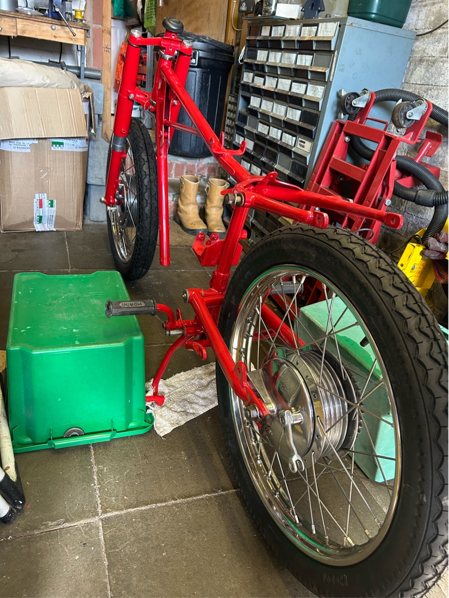

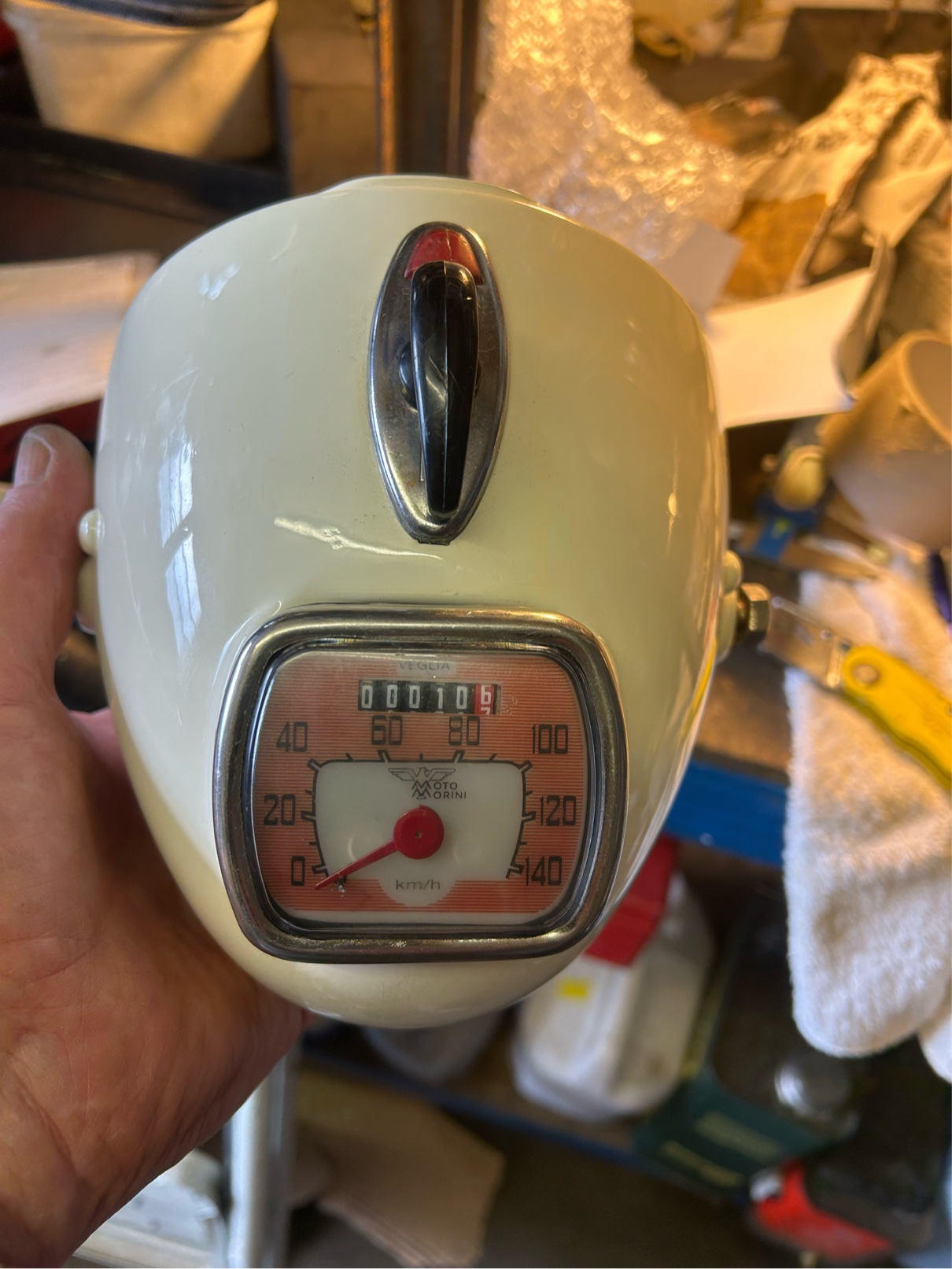

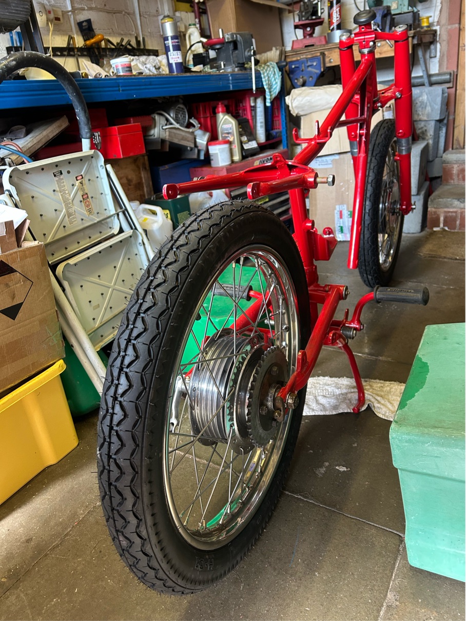

So, after removing the front tyre and putting the wheel on the truing jig as I wasn’t 100% happy with the first attempt (turns out I was overthinking it put the tyre back on and succeeded in pinching three new tubes and gave up in disgust yesterday. Quick visit to my local friendly tyre dealer who repaired two so of the three tubes (he commented on the third saying “Vladimir Putin couldn’t have put more holes in this one”)
I scuttled back into the garage and redeemed myself I hope by attaching the centre stand and rider footpegs and finally putting the front and back wheels into the frame (see attached photos) once I get some rear shocks into the beastie, then the fun can start, I’m happy now it is starting to resemble a motorcycle at last. I’m also starting to warm to the colour scheme as the pictur of the headlight nacelle with switchgear and speedometer in it have lifted it. It wont be Tresette colour scheme per se, but I think it will be individual at least.

Re: New to Tresette
Hi Neil.
Well, it looks like you're getting closer to a complete motorcycle. Indeed, the headlamp shell looks a lot better with the fittings attached. Is there any news regarding the shock absorber build or rebuild?
