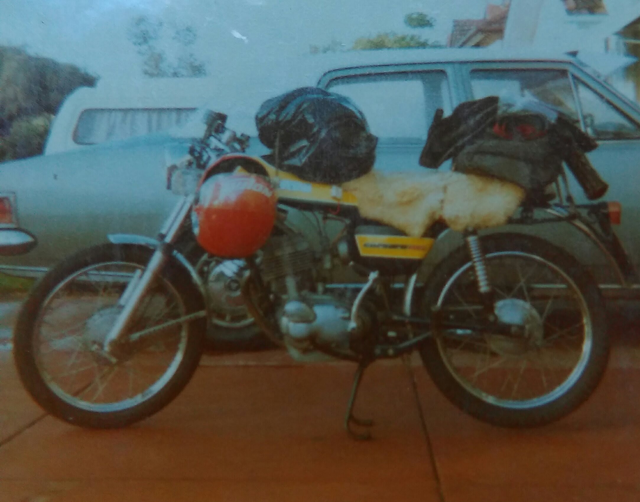

Thanks for your reply. It was mine 30 odd years ago and has not been used much since. I`m sure it has the original pump in it. So would the new pump have the gears in it or do the old ones need to be inserted into the new body ? Also I don`t know what size gears the old has and the new requires. Here it is ready for a trip back in 1985.

Thanks for the photo. The black and yellow paint scheme is cool. I've only ever seen one other like that.
The pump body from B&B is just the body and you insert your own gears. I've seen about four pumps and they all had 11mm gears so as yours is one of the last of the line it's a fair bet that your gears will be 11mm.

Great info, thanks.
There were I believe 15 of these imported into Australia. Some red, some yellow. I know of one person who has 2. One of them has only around 100 kms on it.
