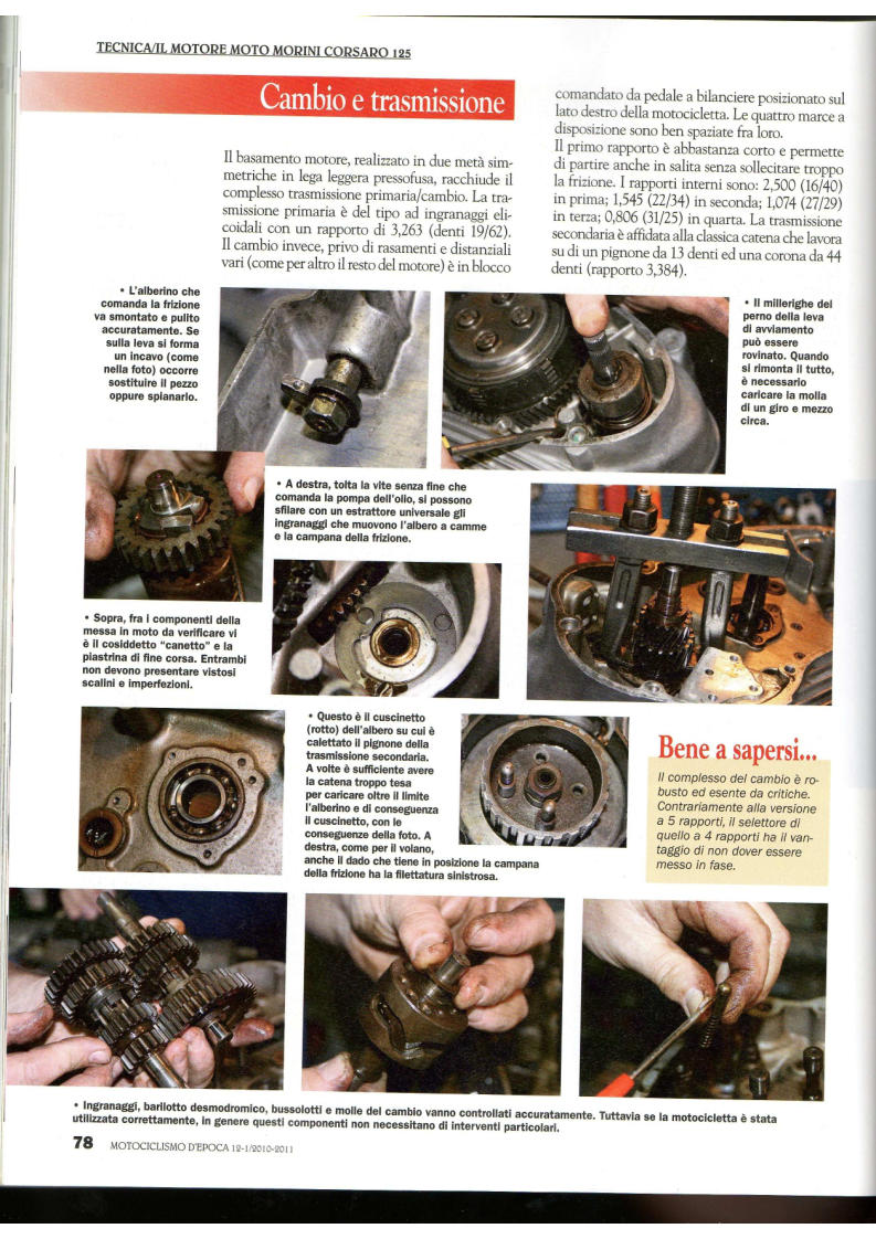

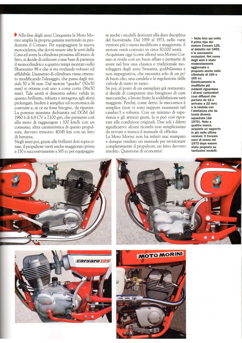

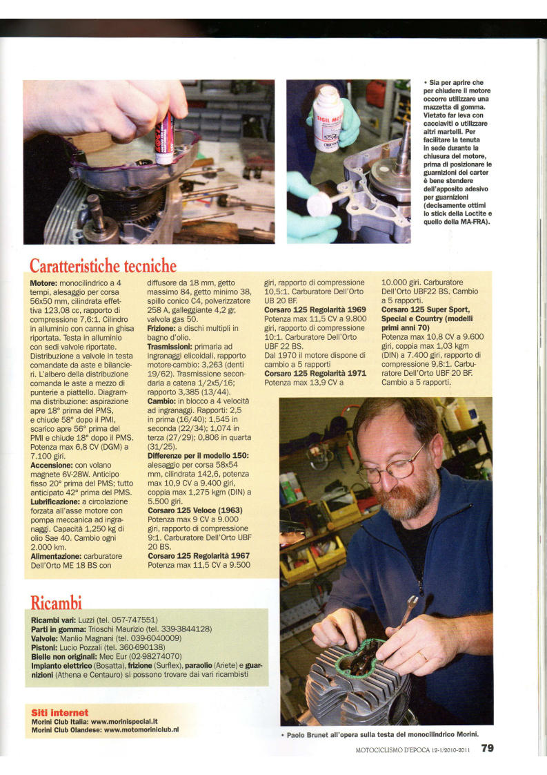

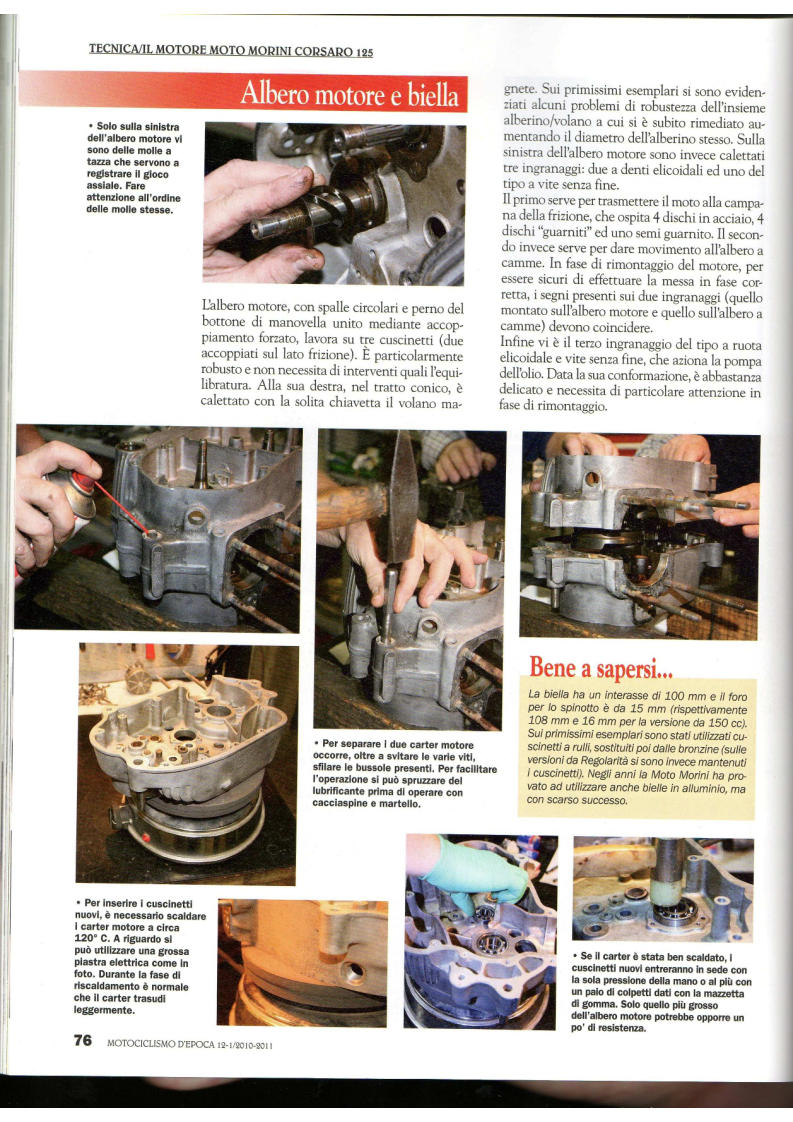

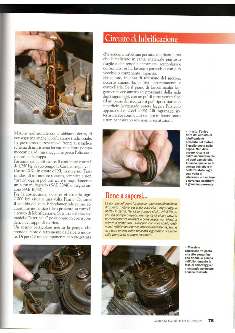

Most of the information I have comes from an article in Motociclismo D'Epoca, Dec.-Jan. 2010-2011. I have a copy of the article on my computer and shall attempt to post it here. If that doesn't work, if you p.m. me your email address I can send it to you that way.

Here we go...
Posts: 400
Joined: 12 Jun 2022 18:49
Location: Warwickshire U.K.
Re: Corsaro kick start return spring
Post by Morini Jen »
Page 2.
Posts: 400
Page 3.
Posts: 400
Page 4.
Posts: 400
Page 5.
Posts: 400
Page 6.
Posts: 400
Page 7.
Posts: 400
Page 8.
Posts: 400
