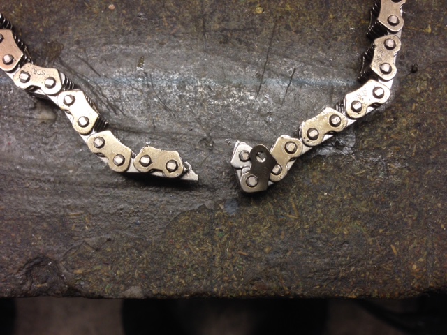

Diagnosis: Cam chain (narrow type) of the rear cylinder broken at 2500 rpm, fortunately nothing else broken, the chain was laying between the two cams, valves were closed.
The reason for this posting: It was a new standard DID SCR0412SV cam chain running just 5000 miles ! A closer look at the old 25000 miles chain and the new broken one brought these differences:
New and old cam chains
At the top you see a brand new DID SCR0412SV, below the broken one and at the bottom the old chain. I decided, not to install a new DID chain but to install the old one until further clarification. If pulled, all three chains have the same length, but the new chains can be pushed together 7,4mm and the old one only 5,4mm. I hope, that the modified chain set with the wider chain will be deliverable within the next months by morini. If not, an alternative maybe Borgwarner which was in a later Morini price list and seems to have a higher specified tensile strength.

by backfat1187
According to Stuart and Rob at NLM, yes, they are currently on chain number 4. Having changed designs and suppliers. The ones they have on the shelf are very slightly wider than the broken one on my 08 bike. Not much though (and I only measured it with a ruler while it was still in the bag) I don't remember the name of the maker but it isn't DID.

Posted: 29 Sep 2016 21:24
by backfat1187
Pesky chain
