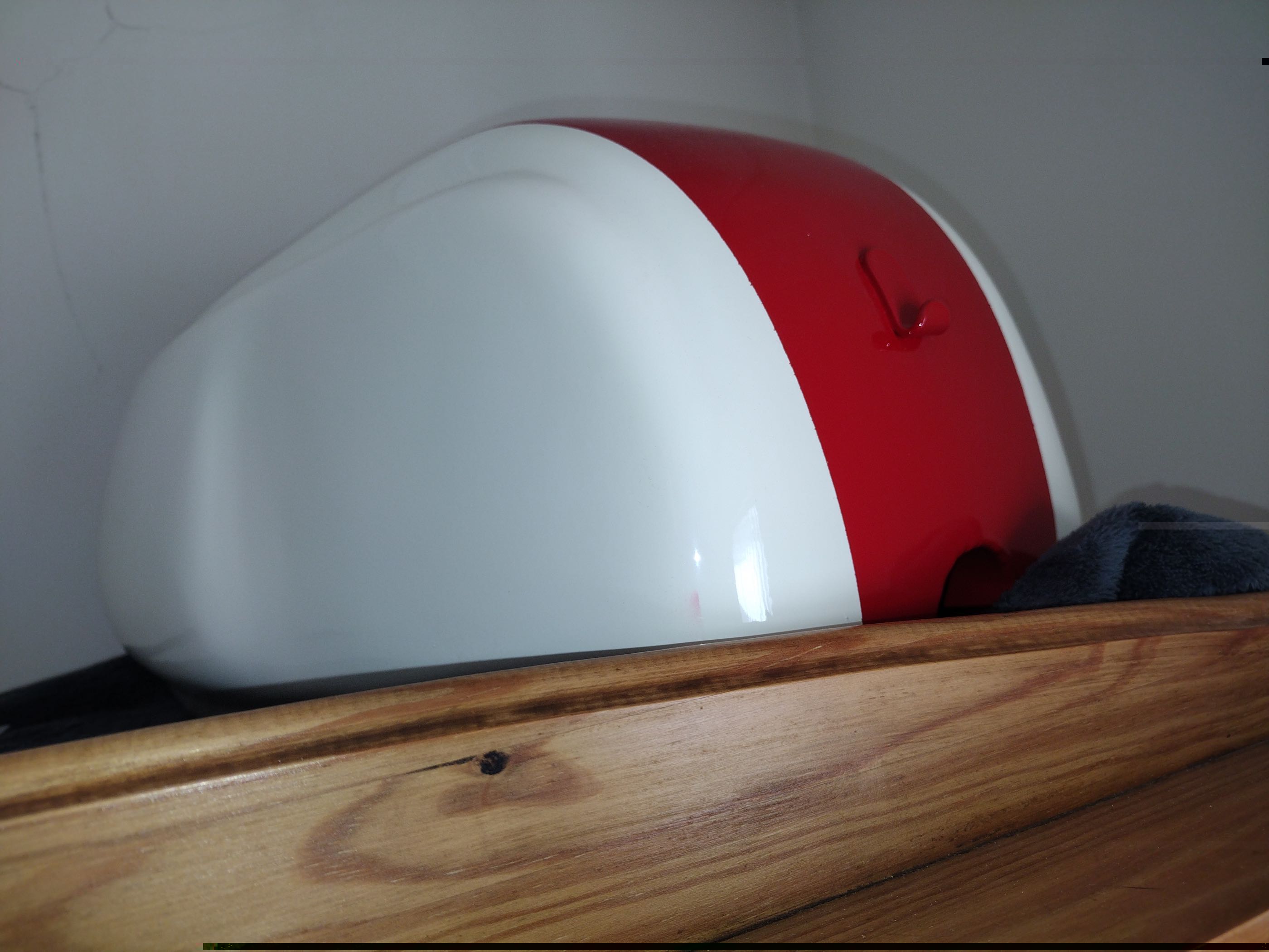

Hi Jen, I can’t claim the red paint, that was done by the previous owner, I am however, going to get it colour matched for the inevitable touch up jobs that need doing no matter how careful you are putting it together, I have my doubts about the tank, as he had it painted in old English white with a red stripe down the middle and the headlight and number plate bracket also painted in old English white to match. According to his wife he was going to have two coach lines in green between the red and the white to make it the colours of the Italian 🇮🇹 comments welcome.

Erm, I'm a bit baffled as to what the previous owner was trying to achieve with the paint job on the Tresette.
But still, 'Il Tricolore' was good enough for Ago's helmet so all you can really say is.. in the spirit of the Morini Riders Club.. each to their own. :)

Morini Jen wrote: 18 Jun 2025 23:22 Erm, I'm a bit baffled as to what the previous owner was trying to achieve with the paint job on the Tresette.
HI Jen, this is how he had the tank sprayed, honestly what would you do? As I said the headlight and the rear number plate/light bracket is spayed the same white.
. To have the headlight,tank and rear light/number plate bracket re painted would add unwanted cost to the project, so I guess I’m stuck with it Non Tresette, but it may look OK when I put it together.
