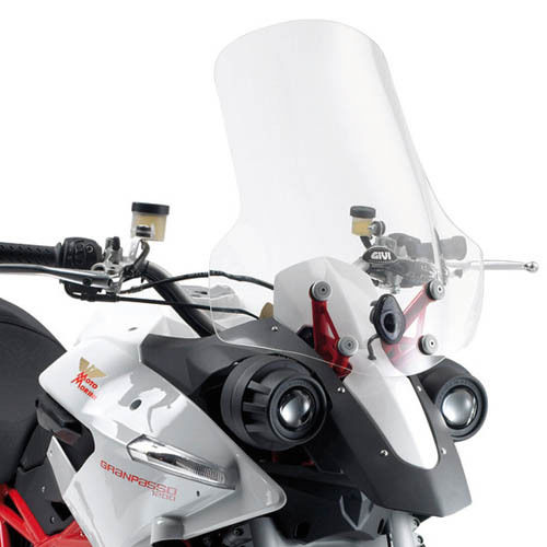

I'd agree with Steve too. Don't delay - buy a GP!
My GP is, literally, awesome and makes my KTM 950 Adv sound like a washing machine. The KTM is still more practical on the washed-out tracks of the high Apennine mountains, though.
I am still adding extras to make the GP more tour-able as in Italy bits and pieces come up for sale every now and again.
Moto Corsa warned me of the chain issue too so I have kept it slack ever since with no obvious problems arising.
I still have issues with the seat height on some gradients when manoeuvring at slow speed, but once underway no problems. And the standard foot rests are not great.
Otherwise a tremendous bike.
I am about to buy the bigger Givi screen, when I can find one down here for the right price... It adds about 10cm onto the top and the order code is D780ST.
Givi Cupolino Screen Granpasso.jpg (29.31 KiB) Viewed 34820 times
