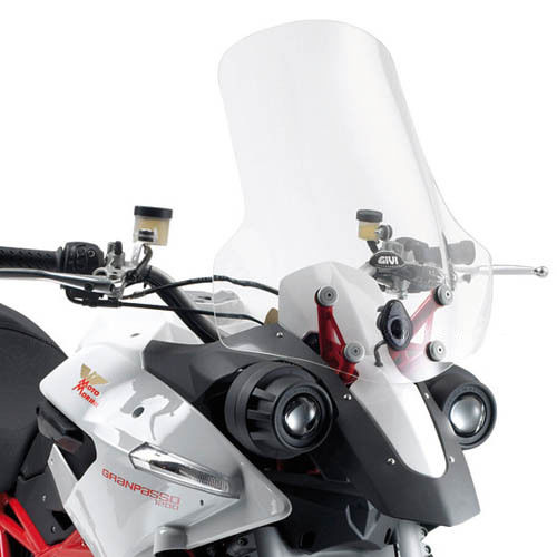

I'd agree with Steve too. Don't delay - buy a GP!
My GP is, literally, awesome and makes my KTM 950 Adv sound like a washing machine. The KTM is still more practical on the washed-out tracks of the high Apennine mountains, though.
I am still adding extras to make the GP more tour-able as in Italy bits and pieces come up for sale every now and again.
Moto Corsa warned me of the chain issue too so I have kept it slack ever since with no obvious problems arising.
I still have issues with the seat height on some gradients when manoeuvring at slow speed, but once underway no problems. And the standard foot rests are not great.
Otherwise a tremendous bike.
I am about to buy the bigger Givi screen, when I can find one down here for the right price... It adds about 10cm onto the top and the order code is D780ST.
