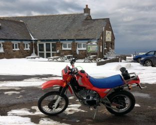

Taxed the Camel today as It was looking forlorn in the garage and I was thinking I may wait for the good weather but may have to wait all year.
Took her up Hartside, so lucky to be so near, and flashed her there. Got on and off OK even when I stalled her at the lights on the way back. It's the tippy toeing to the pavement when that happens that is so shameful, like a wide mouth frog, but different if you get my gist.
She went well and I'm really proud of her, just a couple of faults, fuel leak on a pipe, oil leak from the rear rocker box and she runs out of steam at 6000 rpm, may well be jetting unless someone else has an idea.
The bike not too loud with the new cans, sounds almost Harley, even as deep, maybe.
Anyway that's my first real outing with her and it won't be the last. Another friend in the shed.
- camel at hartside.jpg (96.92 KiB) Viewed 28676 times

Hi George;
Nice photo at Hartside - might even make a January shot for the 2014 calender! (You'd need to send a copy to our editor, of course...). Glad to hear that it runs almost as well as it looks, and I'm sure that you'll fix the last little glitches without too much bother.
Glad to see that you've still got snow up your way! I understand that Spring will spring sometime later this year; the trouble with global warming is that some places will get colder. I think that's us...
Good riding,
