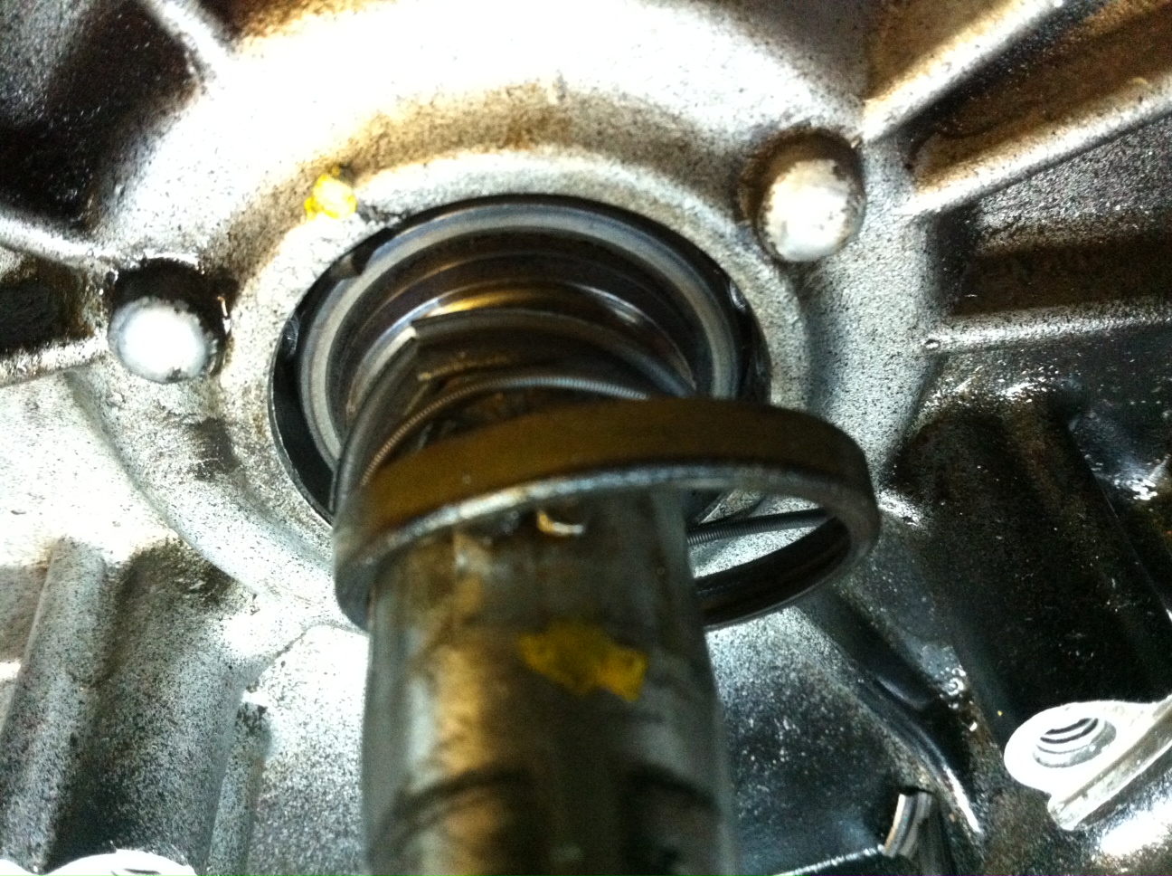

I had a look at my spare 501 motor (also with roller bearing conversion) to get the oil seal code, and discovered that this seal also shows signs of damage. There is a clear witness mark around the seal face, and has split all the way through around 1/3 of the way around (see photo below- this is the seal from my spare motor, but the failure mode I suspect is the same as happened at Cadwell).
Maybe the dished washer behind the timing belt could have been rubbing on the seal, but how? Crank axial expansion in the roller bearing pushing the seal against the lower pulley/dished washer?

I've looked closer and I'm now pretty convinced that the damage is caused by the dished washer contacting the seal.
The seal which came out was a 30 40 7, and this was supplied by NLM so i'm pretty sure it's correct, however I am going to fit a 30 40 5 which will give a couple of mm clearance, and see how that fares...

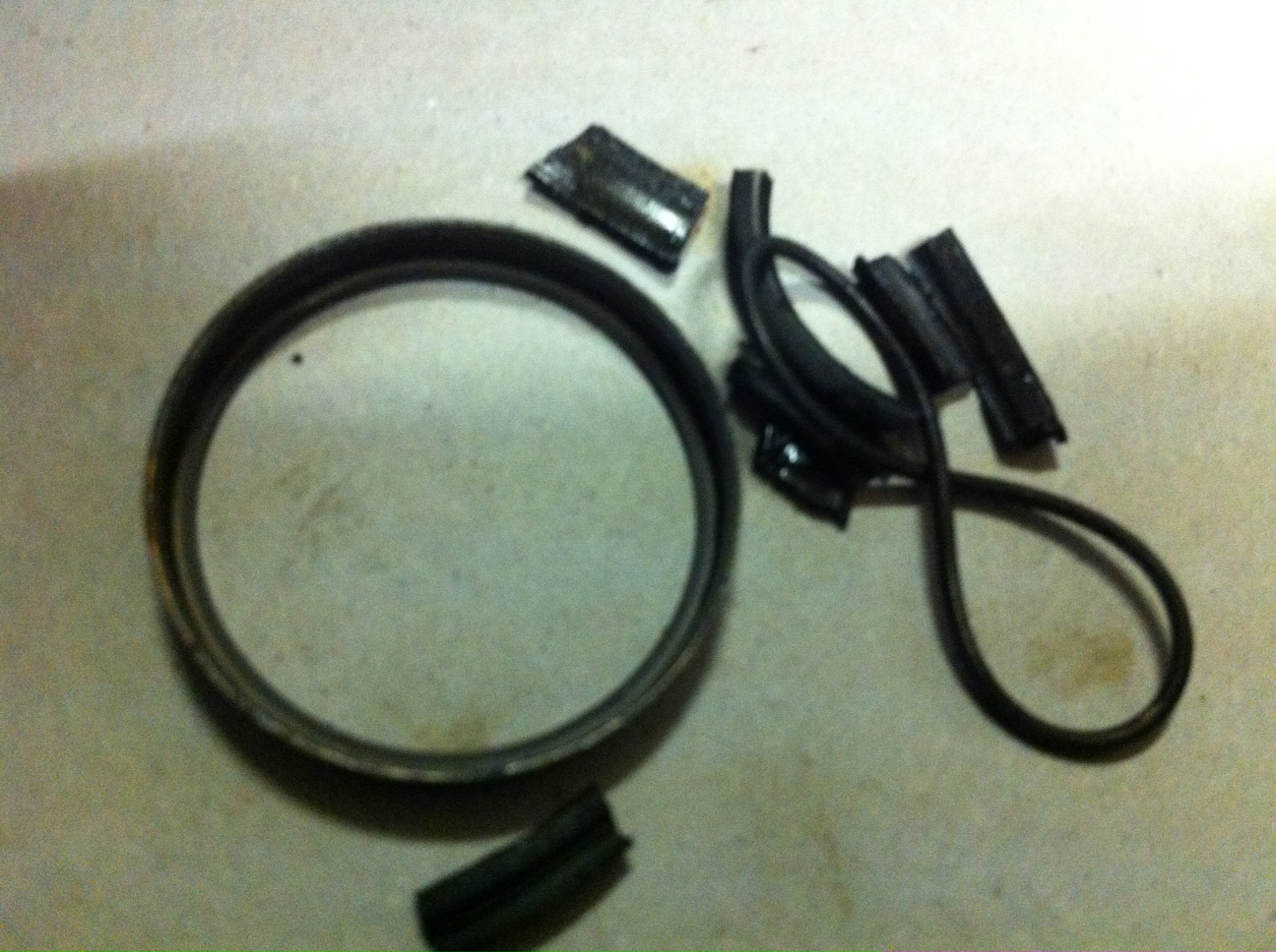

Okay so I've now had a better look and I'm afraid it's terminal. Engine rebuild for me this autumn!!
The oil seal itself was more or less completely destroyed, the metal inner was stripped of all rubber and what rubber was left was very brittle. The crank has blued beneath the oil seal, and the oil seal impacted upon the back of the dished belt guide washer:
all that's left of the seal:

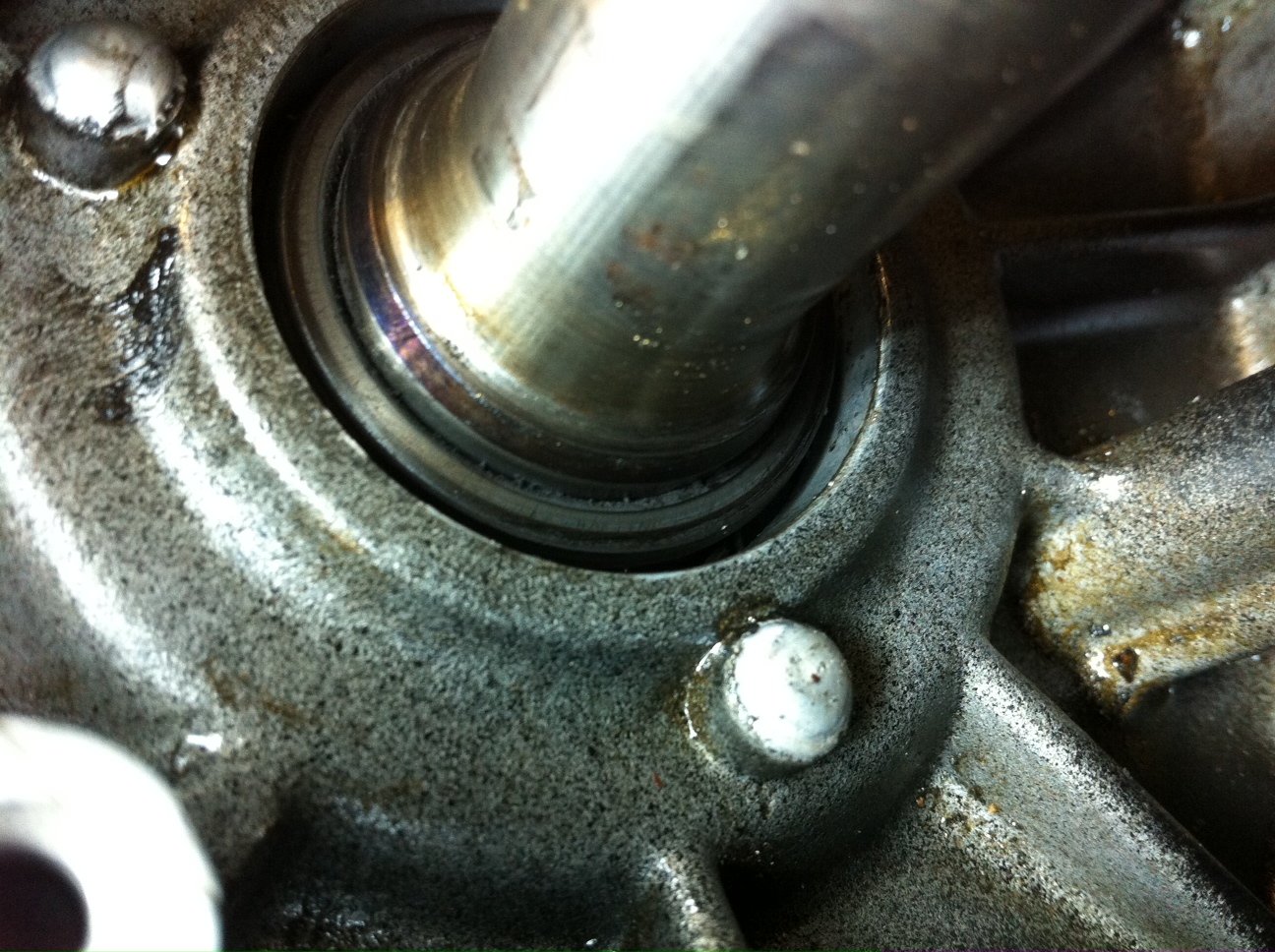

Now the telltale sign that means I have to pull the cases- The inner race of the roller bearing has moved ~4mm outwards on the crank, squeezing the gap for the oil seal down from 7mm + clearance to 4.5mm. You can see in the next photo the blued taper on the crank, then the diameter which the seal runs on, and then only a few mm further back the inner bearing race which is as I say a good 4mm out of place:
I'm keeping my fingers crossed that the plugs I put into the crank oil gallery where the bearing journal was are still in place, otherwise I'll have oil starved bigends too...

Could be wrong but it looks like the inner race as spun on the crank, cant see the seal
getting things that hot, does the crank turn ok and feel all right?

Ouf! Sorry to read that it is worse than hoped. :(
I think Frank might be right about the spun bearing.
