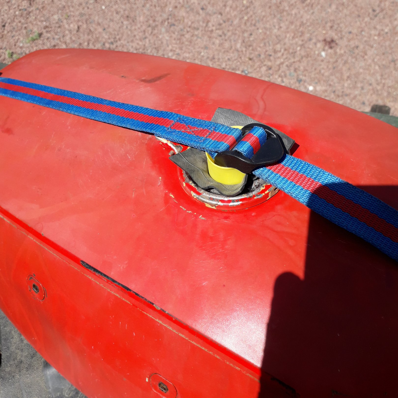

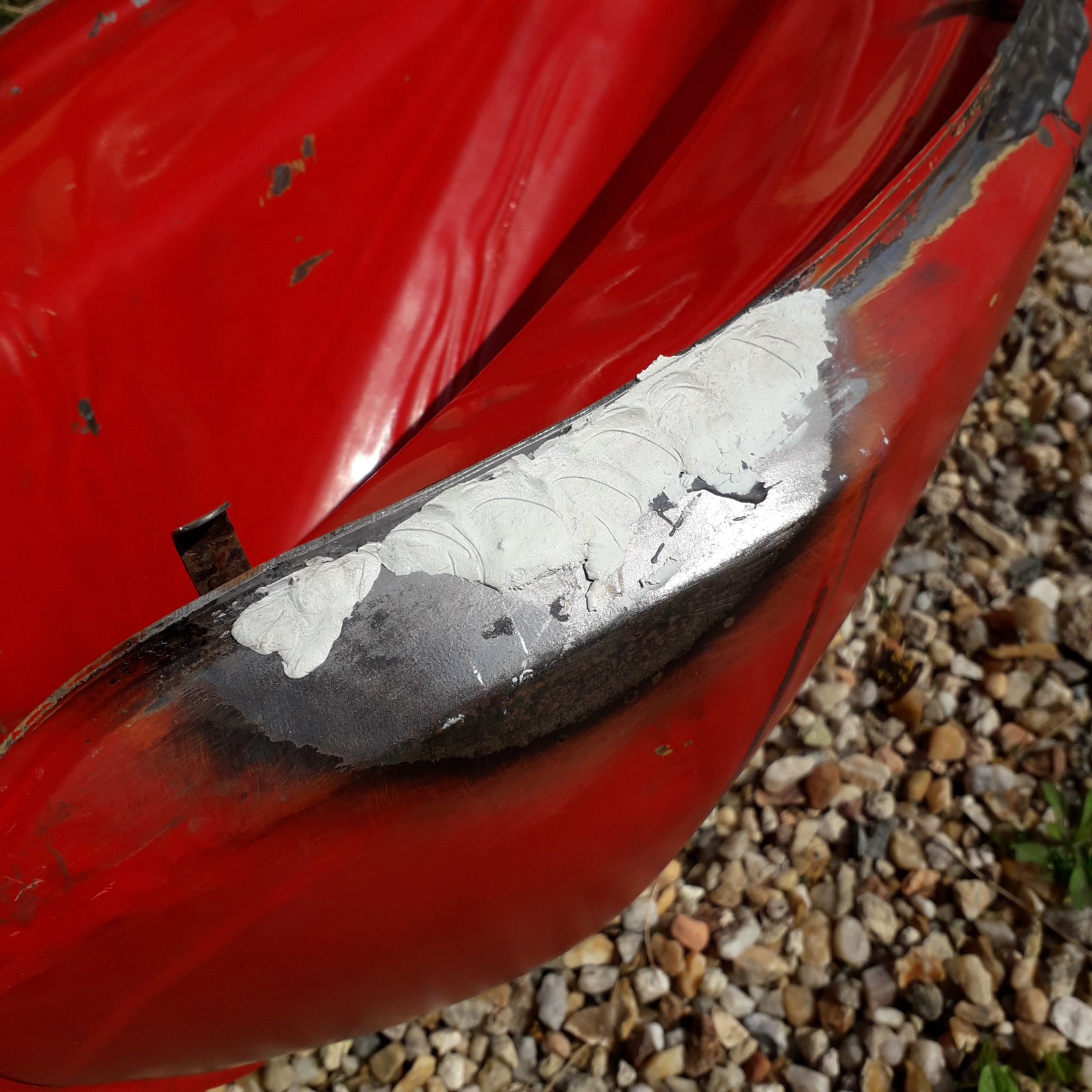

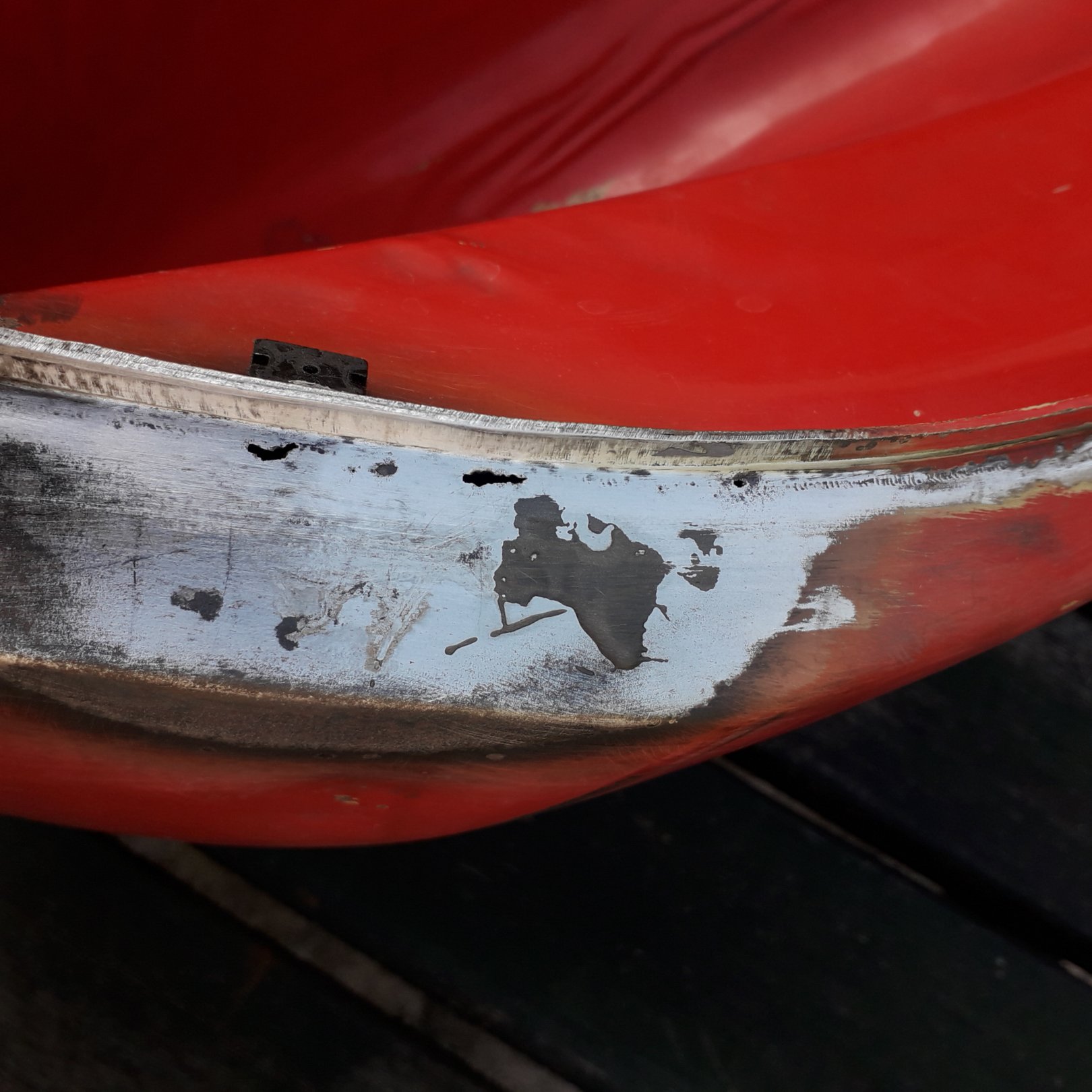

At last, a bit of an update. As the weather has improved of late I have set about sealing the tank (rusted along the outside of the seams), I am using a product called 'Slosh', with any 'big' holes sealed on the outside with an epoxy resin. It is currently in the curing phase.
As for the K2, it's still awaiting registration under the new, improved, all-internet French registration system (what used to be done by a visit to the local prefecture, maybe 2, is now done on-line and has taken 4 monthe so far, with no light at the end of the tunnel :evil: )
Tank piercings.jpg (271.56 KiB) Viewed 36897 times
Epoxy support.jpg (325.6 KiB) Viewed 36897 times
Cunning bung.jpg (337.83 KiB) Viewed 36897 times
