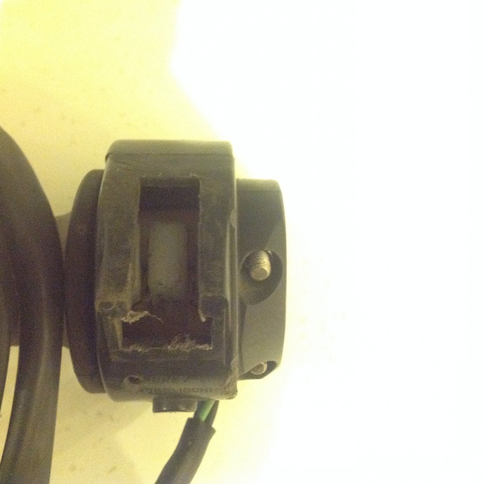

The throttle stop is missing on my 350 Sport K1 and when you let the throttle close it goes too far and the nipples of the throttle cables jump out. Does anyone have the part number for the right hand handlebar switch and throttle tube. Many thanks.

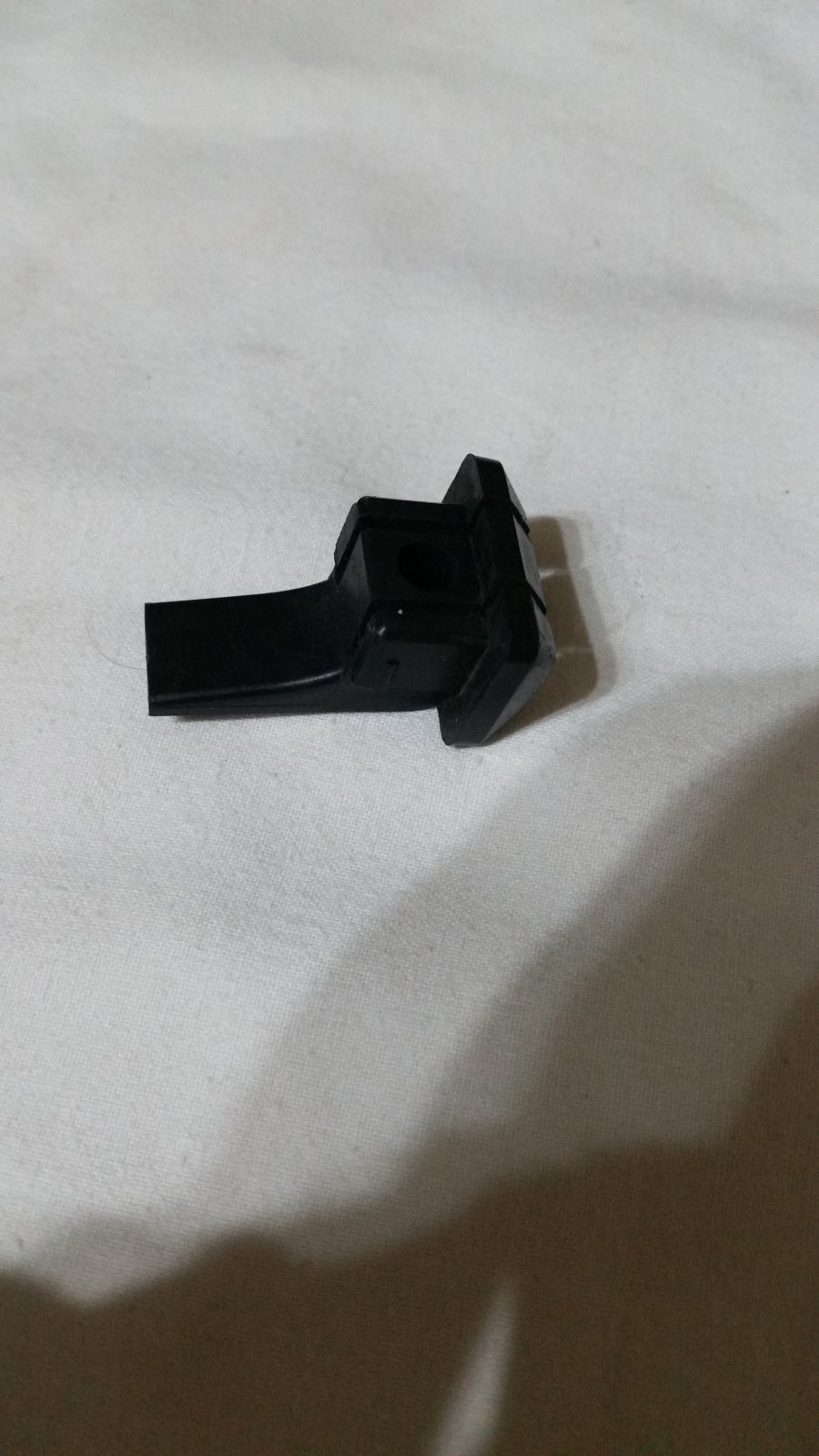

Are you referring to the plasic block that holds the cables into the twistgrip?
The one shown on this link; https://www.ducatiforum.co.uk/threads/t ... tle.46541/
If that's present, then adjust the slack in the cables.

The blocks were made with two different depths of holes for the cables and it's not uncommon for the block to have been drilled deeper to suit supplied cables. Add to that the ability of Venhill to supply cables of quite random lengths and you can have cables that are too slack.
Rather than me and other people guessing, can you take the twistgrip apart and take some pictures.
