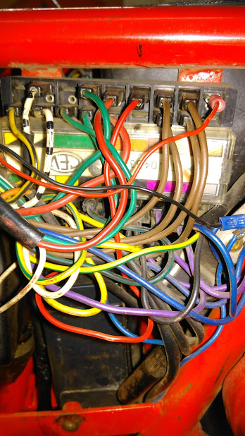

There is a red, green and white wire from the generator. I have relocated the red and green, but not sure where the white one plugs into. HELP !
This is a pic I took before disassembly. See the white one disappearing down under the fuse box ? I should have documented where that one went Doh !
I have looked at wiring diagrams, and what I have seems to be different to the drawings. I am not great with wires and wiring diagrams so some practical help would be fantastic.

I'm no expert either, but is your fuse board fitted upside down? I've just replaced mine 350 Strada, and all the red and green wires on mine are on the bottom run of connectors. The writing on the fuse cover is a bit of a give away but maybe an Australian model? :)

Unless the actual picture is upside down. :wink:

Dont know if it`s the right way up or not. Who knows what previous owners have done.
Good news though. I plugged it in to the bottom left area where another white wire came out. It works !
Spent all day fitting the motor and connecting it all up, and she runs sweet.

The white cable from the generator normaly is earth

I believe it goes to the transducers to complete the ignition circuit.
