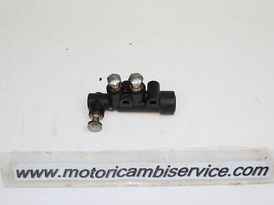

You might be lucky and find someone who has an unmodified 500/K1/K2 and can photograph the splitter, but I seem to remember it was a 'generic' sort of part used on many bikes of the period, like this:
s-l400 (1).jpg (11.4 KiB) Viewed 8751 times
It was attached across the bike, to the underside of the yoke by an angled bracket.
George.

Ah yes, I can see how that would work.
Thanks for the photo.
I’m wondering why a 2 into I arrangement would be used rather than just running 2 lines.
Re: Bottom yoke holes thread size.
Posted: 15 Jan 2021 19:59
by George 350
My guess is legal - need for a front brake light after (1982)? - there was a single brake line 'splitter' also available at one time. Or simply packaging. I must say that on my Sport the bar/lever position for best comfort for me is with the banjo bolt from the master cylinder almost touching the speedo, so having a longer bolt and a second line would compromise something, possibly thumb yo tank on full lock?

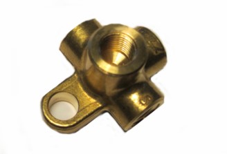

If you want to place a stoplight switch as well you have to look for this. It should be awailable at allmost all hydraulic (brake) shops.
4fachm10x1 Verteiler.jpg (9.79 KiB) Viewed 8676 times
