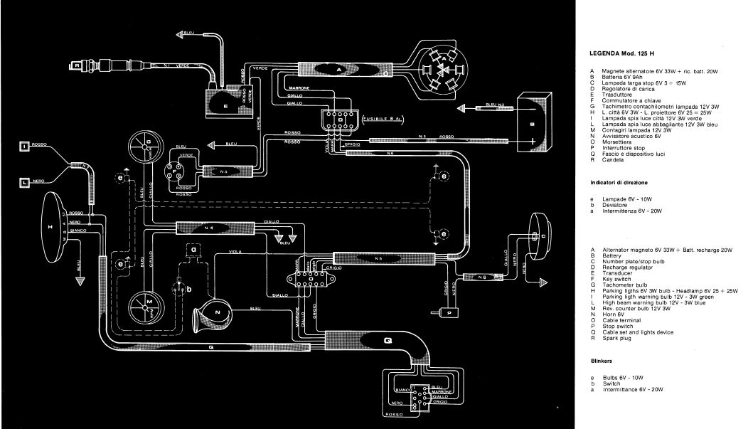

with the 125 the iginition system is differrent. The pickup is on the stator.
I have some documentation specific to the 125H/T, i can send it through wetransfer
- 2021-09-02 09_48_00-blaabog.pdf - Adobe Acrobat Reader DC (32-bit).jpg (88.11 KiB) Viewed 34706 times

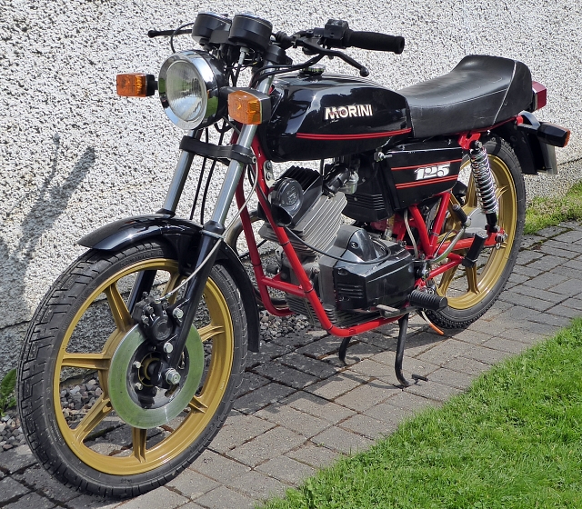

I have a 1979 125H, with cast wheels and rescued from the Isle of Cumbrae in the Clyde, about 15 years ago.
When first purchased the engine was reluctant to pull above 40mph and the bike was put to the back of the workshop. This year after wrestling with a recalcitrant Ducati single for 22 months, it was the AAU that was faulty, I have tried to get the 125H up and running again.
After lots of assistance from Benjy Straw and Mark Bridger, in relation to resistance values, voltages etc. and to take them. (Remote diagnostics are not easy, when dealing with my limited electrickery abilities!) I replaced the original Ducati Electronica transducer (323921) with the more modern "equivalent" Ducati Electronica transducer (32398 112 21 02), purchased from BeedSpeed, I think only the first five digits are relevant? However, I can find no information as to whether the advance for this 2 stroke transducer is as great as that of the original transducer. Whilst the engine revved more cleanly, it would die once hot or after approximately 5 miles. Further testing showed the magnetic pickup to potentially be at fault so this was replaced with a 'pattern' Lambretta 12v magnetic pickup mounted on the 6th pole of the Ducati Electronica stator.
At present, the engine will tickover quite happily @~1,100rpm, but it dies when revved to ~4,300 rpm. When I try to engage the clutch the engine dies before taking any load! I am suspicious about the ignition timing at low revs and the degree of advance that is available from the replacement transducer.
Trying to time the engine using a Xenon timing gun proves fruitless, as before 6,000rpm, the revs at which the ignition is supposed to be advanced to 36°BTDC electronically by the transducer the Xenon tube stops flashing as the two stroke ignition providing a "wasted spark" appears to overload the guns circuitry. Using an antique Gunson neon timing light wired in series with the ignition lead, shows no advance in the ignition timing, before the engine dies. When timing the ignition, because the mechanical tacho drive is removed along with the right-hand engine case, I have no way of knowing what revs the engine is at?
Does anybody know what the static timing is for a 125H? The NLM 'Blue Manual' does not contain this information and vaguely describes "....punching timing marks on the stator plate and engine crankcase....", once the ignition timing has been set at the requesit 36°BTDC @6,000rpm! Not much use if you cannot measure, or appear to achieve those parameters in the first place.
What is the advance curve programmed into the Ducati Electronica transducer (32398 112 21 02)?
Are there any other tests or methods that I might try to set the ignition up?
Does anybody have any experience and or data for the 'BGM' components from Germany? Link:BGM_tuning_ignition_components_for Vespa_&_Lambretta
My final resort is to replace the ignition coil on the stator or have it professionally rewound. But, as I seem unable to get the engine to run under load now, I cannot check to see if the insulation on that is breaking down after a period of running.
Thank you for your time to read this. The culprit below is living up to it's bye name!
