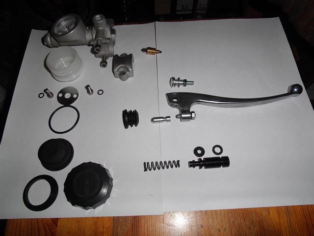

Just looked through my parts I bought for the K1 rebuild.
Caliper pistons are 41mm diameter front and 32mm rear.
Master cylinder seal kits are 16mm and 13mm. The 16mm is the front master cylinder, which came from a 31/2 Sport with a single disc.

Re: Twin Disc Master Cylinder
Post by Mark »
All very interesting.
I have a 16mm from a single disc bike so I’ll try that first.

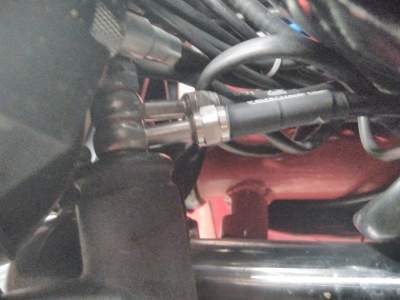

I also have a problem with the double banjo for the Grimeca colliding with the clock (I have the earlier console fitted) but the smaller single banjo clears it so it’s looking like I’ll start off trying 16mm/single disc as I may have no other option anyway unless a 90 degree double banjo exists?
Yes, it is tight. Try looking for something like a Laverda 500 splitter that fits on the bottom yoke.
Picture shows the tightness.
