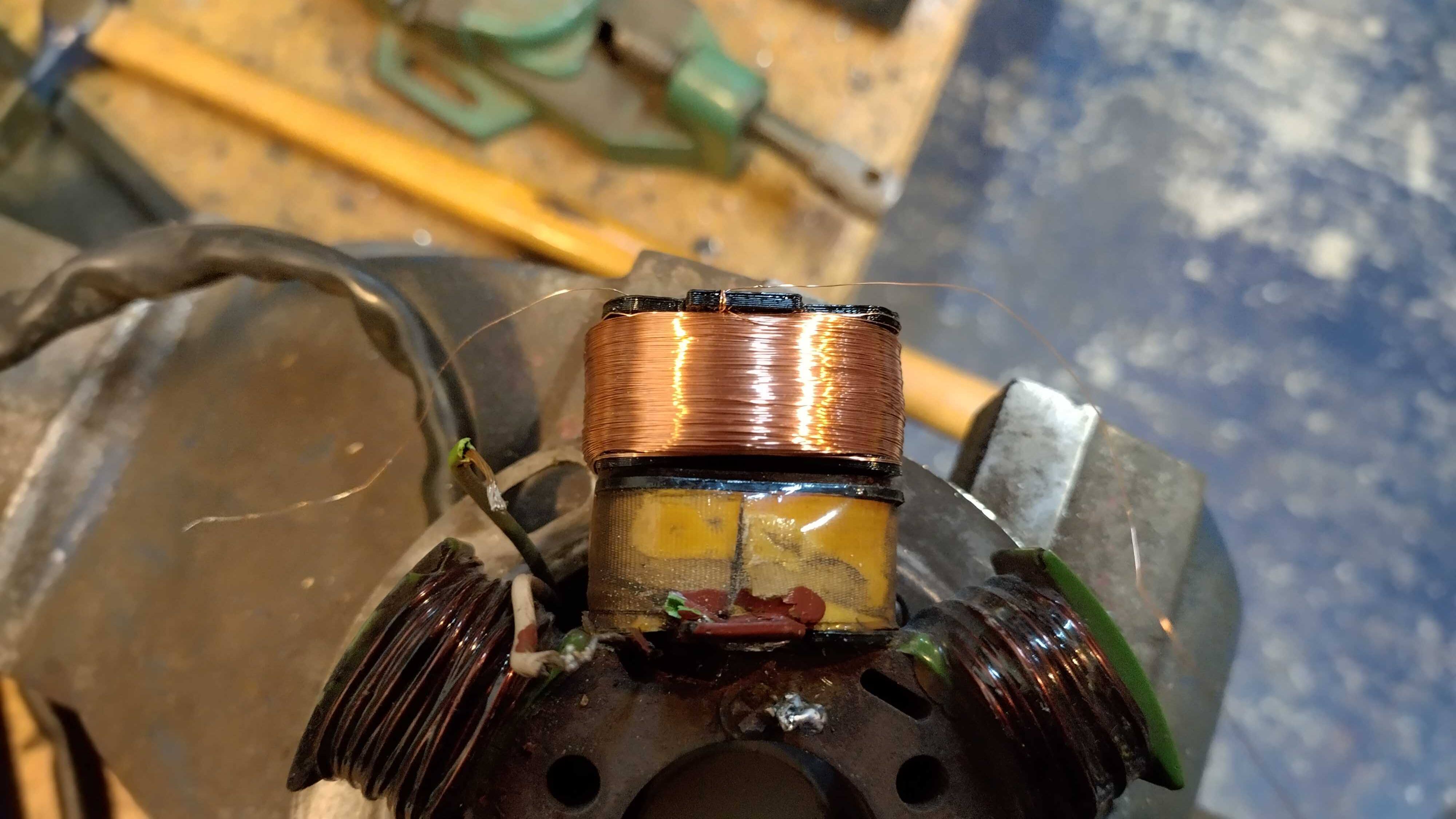

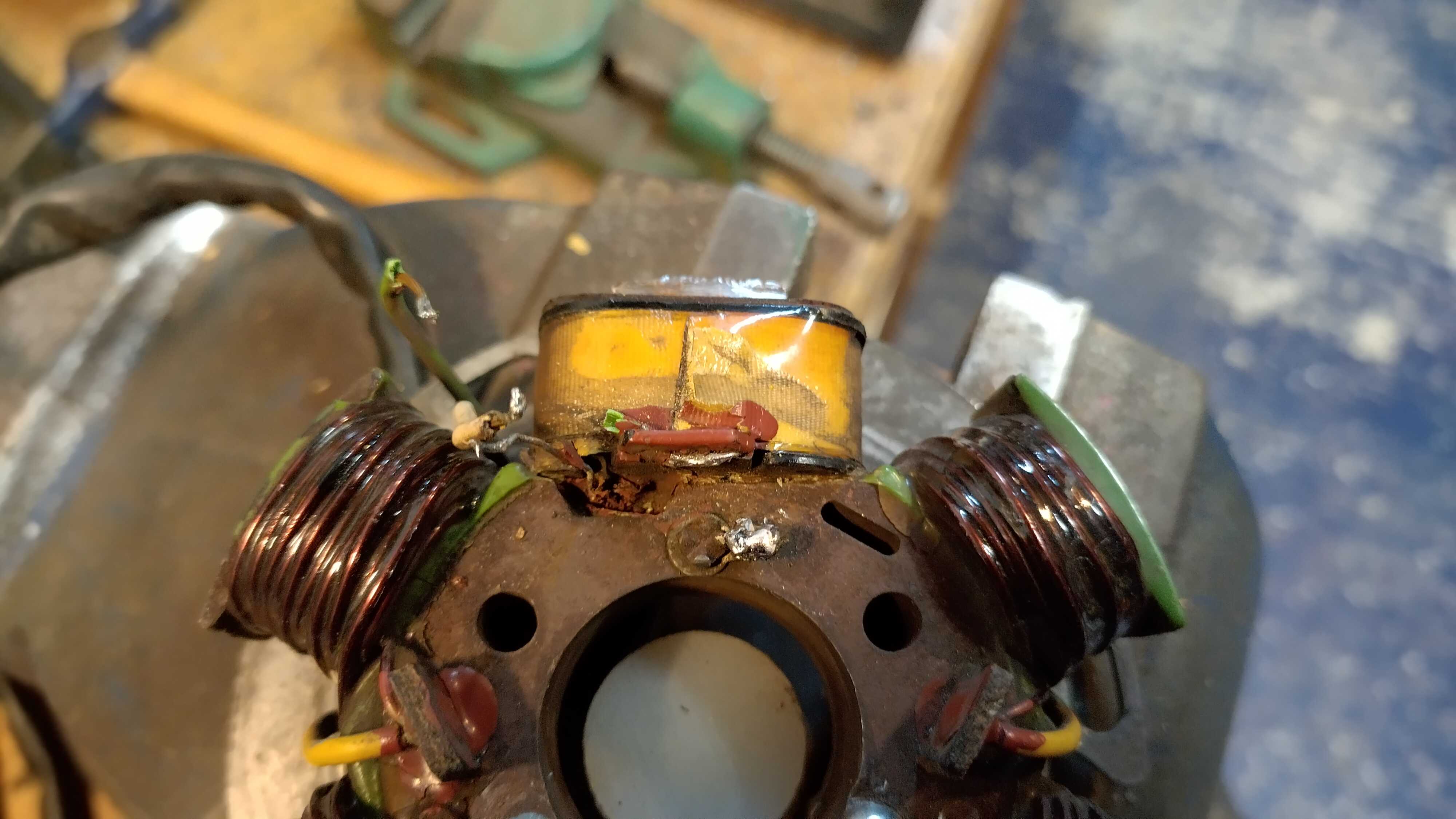

I am having a go at winding a new low tension ignition coil. (See a previous post).
I have printed a bobbin in TPU (material I have to hand and good enough heat range, even if a bit rubbery). I have also constructed a Heath-Robinson coil winder. So 2 questions:-
1) Any hints or tips for removing the old coil. I have the copper retaining plates removed, how do I get the old bobbin off? Preferably without destroying it!
low tension coil.jpg (377.29 KiB) Viewed 241 times
2) I have wound about 3200 turns onto my bobbin. It looks very full! I guess I did not have enough wire tension on it when winding. It measures 310 Ohms. Will it be ok or do I need to do it again? (I do hope not, 3 hours-ish to monitor it while it winds).
New wound bobbin.jpg (496.28 KiB) Viewed 241 times
Thanks, such fun......

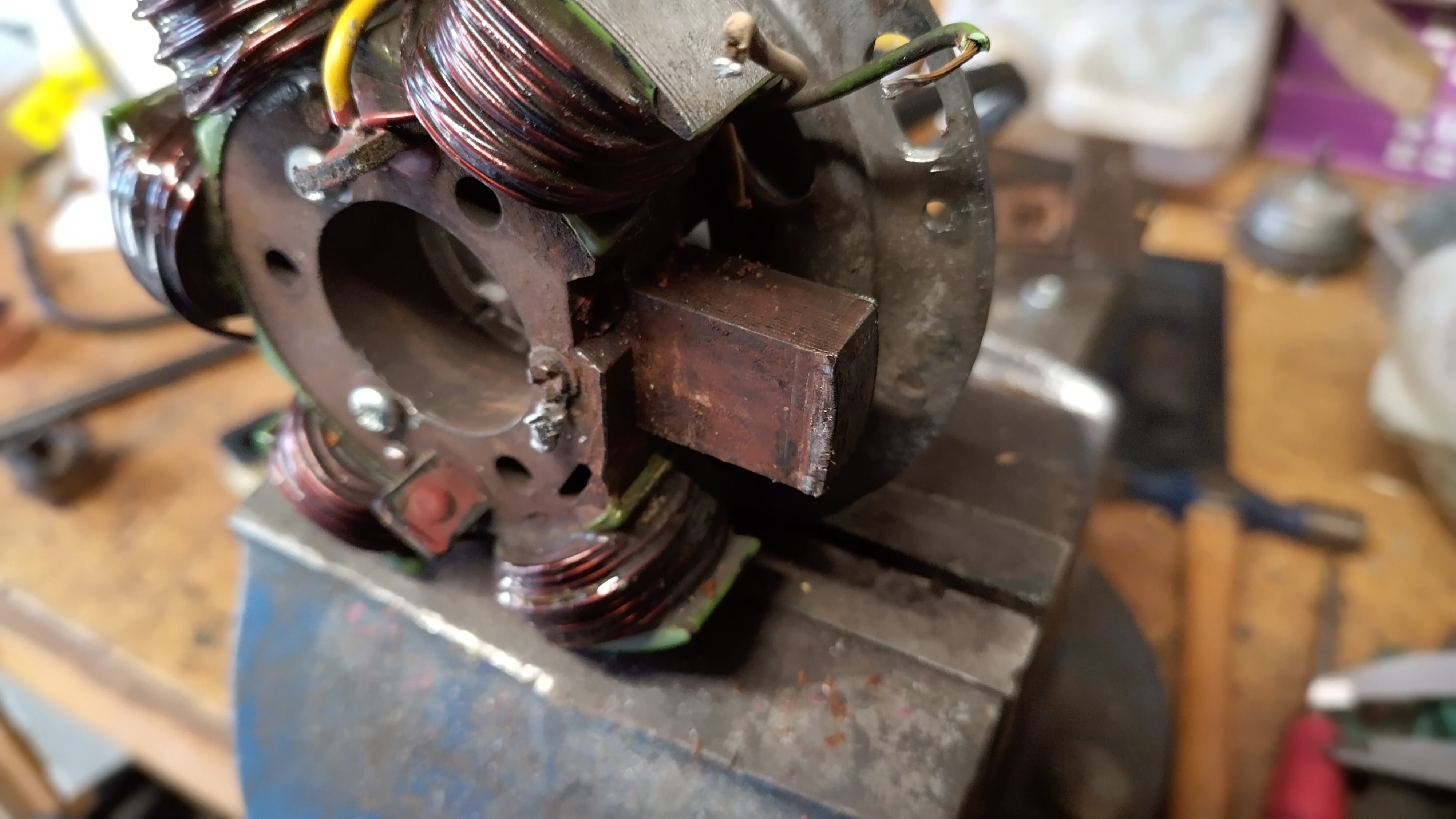

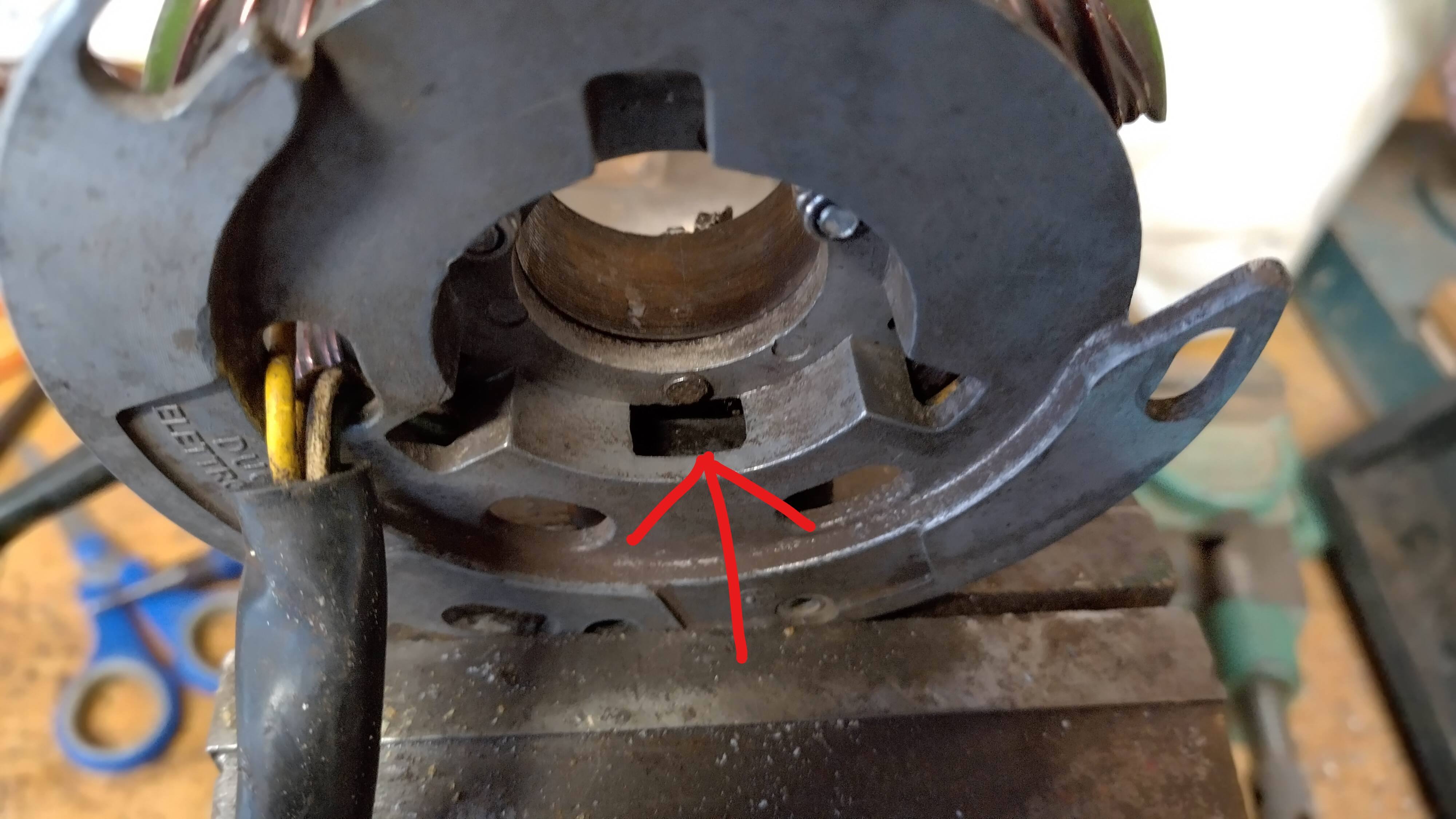

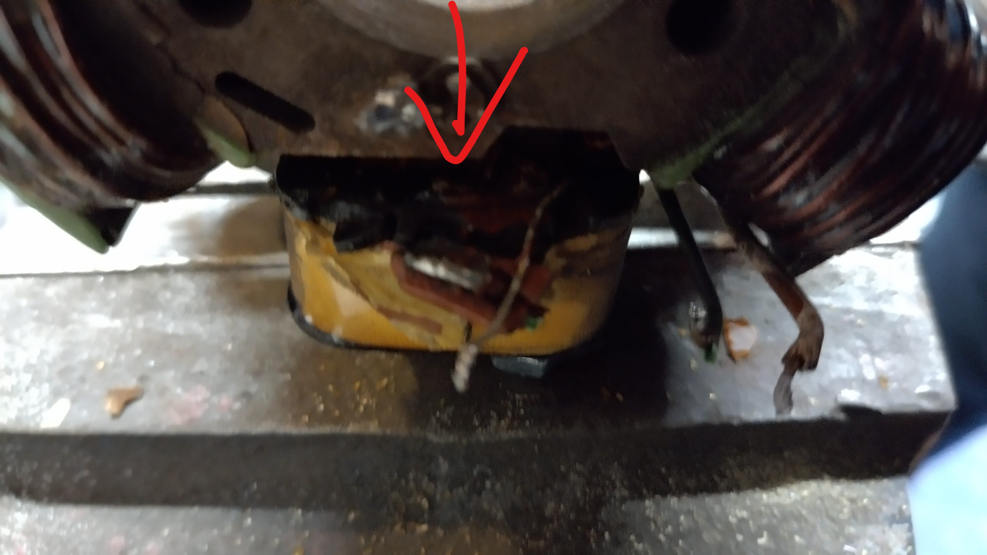

So a bit of brute force and a little ignorance! I have used a drift and light tapping through the hole on one side and again on the other:
Then used some emery paper to clean up the laminations.
