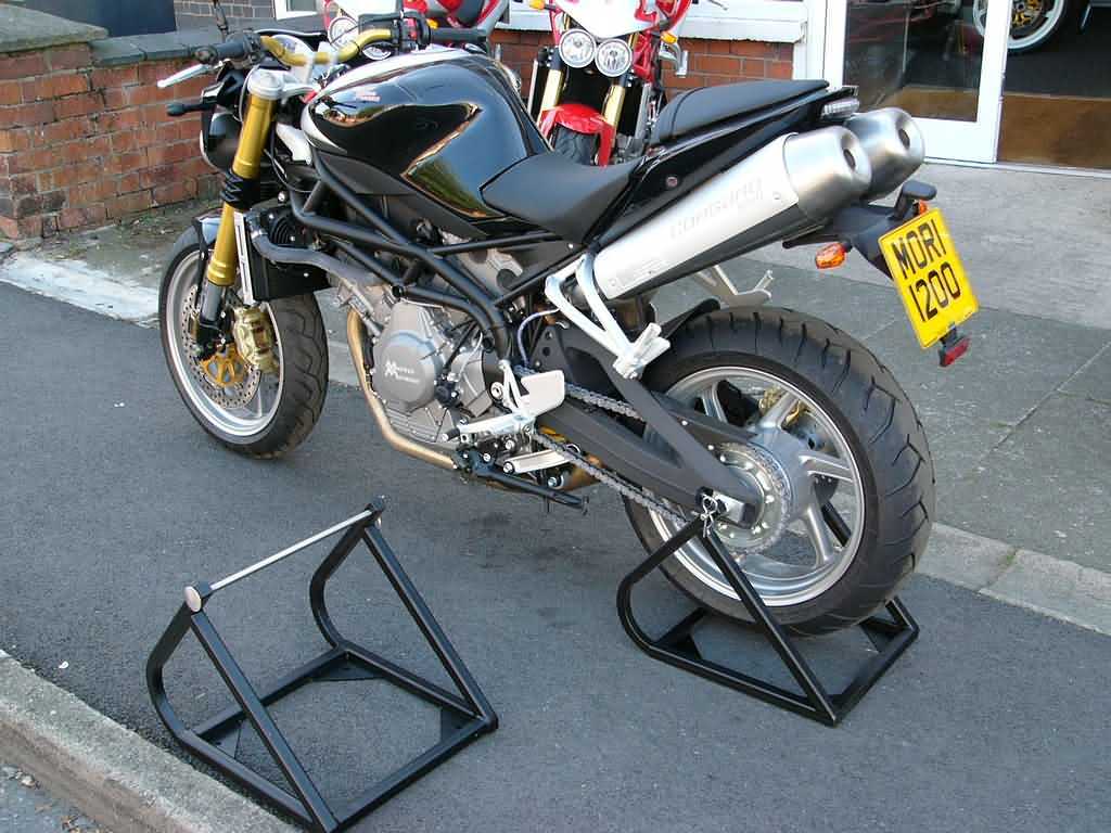

How about this. Put it through the hollow rear axle and push/pull the bike back.
Price and details at the bottom of this page:
http://www.northleicestermotorcycles.co ... morini.htm
http://www.northleicestermotorcycles.co ... 0stand.jpg
Corsaro axle stand.jpg (81.5 KiB) Viewed 10504 times

Thanks for that -
looking at the pics it seems all I need is a length of steel bar to pass through the eyelets of one of my existing paddock stands !! :D :D

yep- That's exactly what I was trying to describe! :D
