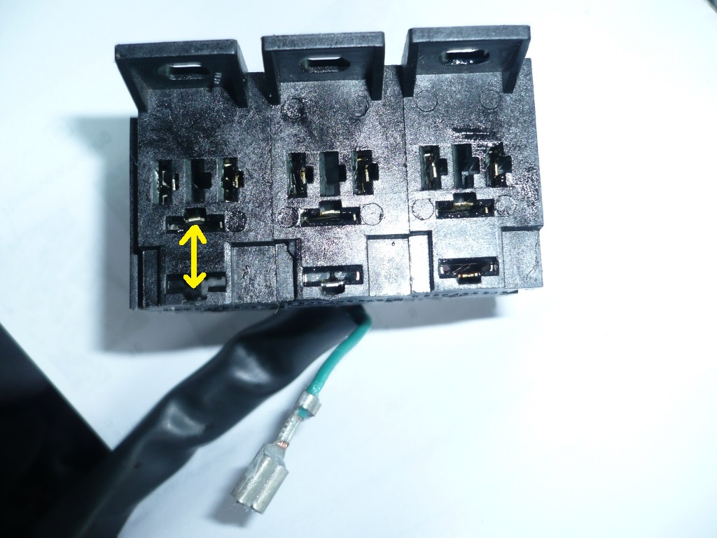

hi stauch,
i don`t understand, which light does not work? low and high beam? both? please use "english" for your translation from russian!
the headlight-relays are activated by the speedometer.
first aid, you could remove the relays and bridge with a cable the wide contacts in the relay-socket. don`t forget to switch on ignition!
when the headlights light up, you have to check the way from the speedometer. i know that problem from many corsaros.
there very often the speedometer is faulty.
here the corsaro relay-socket, only as an example
sbarazzino 98, corsaro 125, corsaro 150, corsaro 1200, scrambler

Il problema è stato nel pannello di controllo. Günni, hai ragione. Io risolvere il problema. Grazie, mi hai aiutato. (two lights did not work. distal and proximal)
Re: sensore di velocità
The 3 relays operate the high beam, low beam and the radiator fans on my Corsaro.
I have replaced the 2 relays for the lights as they were faulty. The originals were poor quality and were not sealed.
I now carry a piece of wire with large spade terminals so if the relay fails at least I have a light.

Electrician put one relay with 4 wires and bypassed the dashboard.
