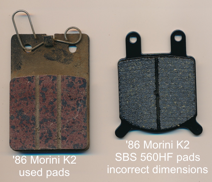

I stripped out the rear caliper and noted that the replacement pads didn't have the central metal tang, in which the anti-squeal, stainless steel spring sits. :? However, in every other way they matched the pads that I had removed and everything went together and worked.
On to the front calipers. On stripping out the pads they appeared very different from the SBS 560HF that I had ordered. :? Being longer, wider, with no two 45degree tangs/lugs sticking out from the bottom of the pad, as on the SBS 560HF pads.! Again, no central metal tang, in which the anti-squeal, stainless steel spring sits. Upon sliding the new pads into the caliper, the tangs/lugs held the pads lower in the caliper and the holes through which the pins hold the pads in the caliper didn't align. :roll:
I then visited the EBC, VESRAH, web catalogues, with no joy. EBC do not list a pad for the K2 front calipers, they used to list a pad FA98 or FA098 as being suitable, but this is of similar dimension to the incorrect SBS (560HF) pad. The Vesrah catalogue showed a pad of similar design (SD-928) to the incorrect SBS one. NEWFREN I believe were the pads sold by NLM (FD0028) for Morini front calipers and they too have the same profile as the incorrect SBS one. I suspect that the pads with tangs/lugs are suitable for earlier MM 350 Sports? MDITALIA do not offer a description/image of the pads that they are selling for Morini, apart from being "soft". So, take your chance! :roll:
Ferodo's online catalogue finally came up with some correct information. :D Not only did they list/illustrate pads with dimensions matching those of the pads that I had removed, but they also cross-reference other manufacturer's equivalent pads. I have checked the FERODO (FDB696), EBC (incorrect!), NEWFREN (FD0069), SBS (605HF), VESRAH (VD-930) pad dimension on the manufacturer's sites and all appear to be of similar dimension to the unamed pads that I have removed from my front calipers. :D Pad friction materials vary!

1986 Morini 350 K2 front brake pad comparison
