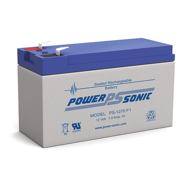

I use a generic SLA battery. Way cheaper & lasts for years.
SLA battery.jpg (43.96 KiB) Viewed 5442 times
