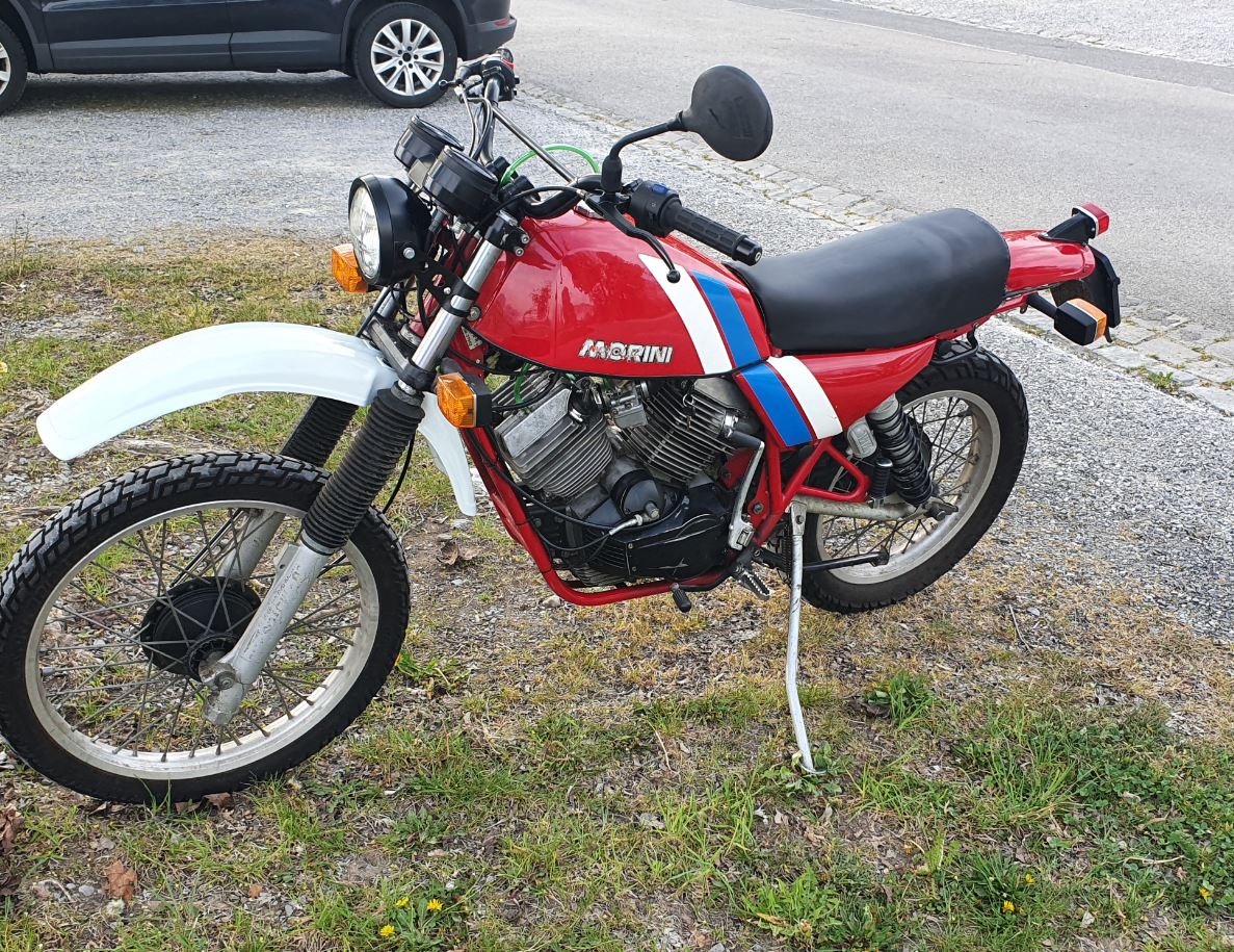

This is my recently completed Camel Mk2 (well I think it's a Mk2).... Cheers,
Kamel
Yes i believe that is the right way to read the dimensions.
How about posting some pics?
Kamel

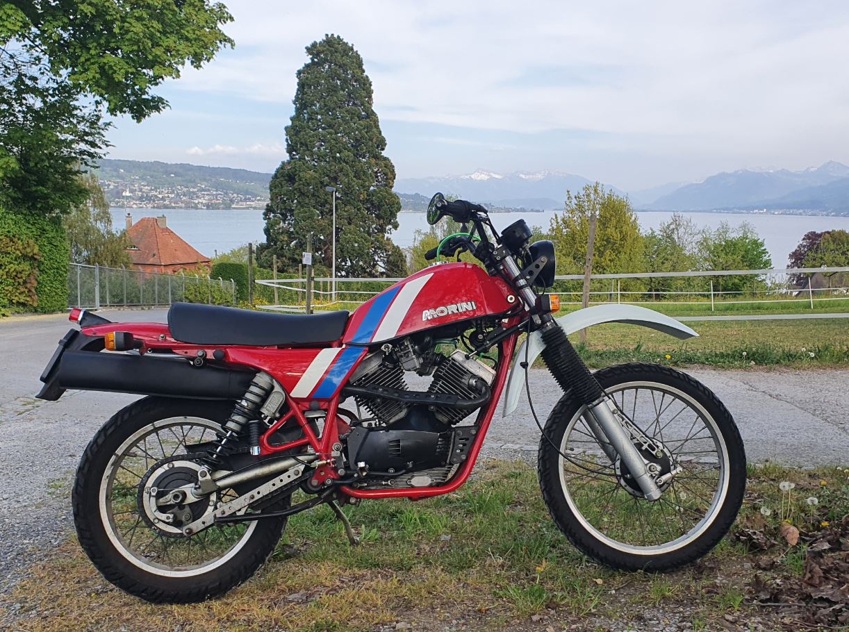

Re: Camel woodruff key
Hello Kamel!
Your bike is quite lovely..... My bike should be ready for the road today! I will take plenty of photos....fingers crossed. Ben
Very nice Ben !
That a steel tank?
That a steel tank?
Thank you! Yes, it is a steel tank... Ben
Kamel wrote:Very nice Ben !
That a steel tank?
