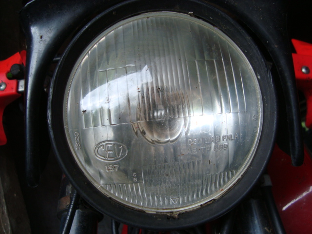

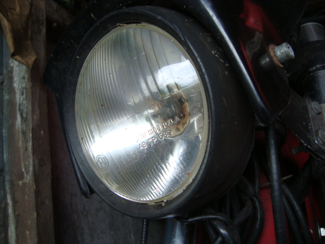

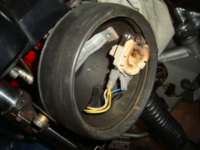

Camel 500 headlights
- CEV glass Camel.JPG (130.29 KiB) Viewed 3022 times
- CEV glass Camel 1.JPG (140.74 KiB) Viewed 3022 times
- CEV 140mm Camel.JPG (136.22 KiB) Viewed 3022 times

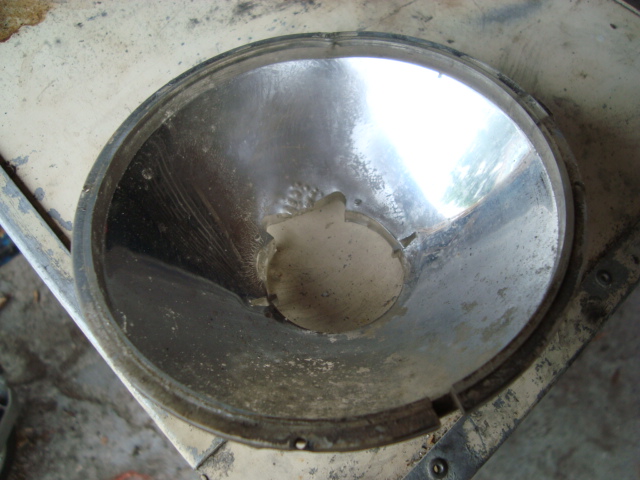

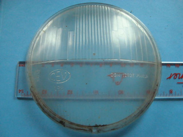

Camel 500 plasic headlight unit
- CEV plastic Camel (2).JPG (124.32 KiB) Viewed 3021 times
- CEV plastic Camel (1).JPG (135.84 KiB) Viewed 3021 times
