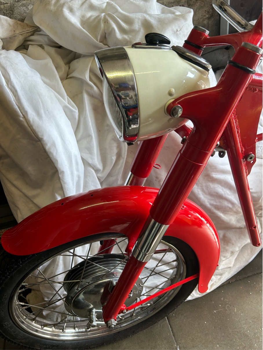

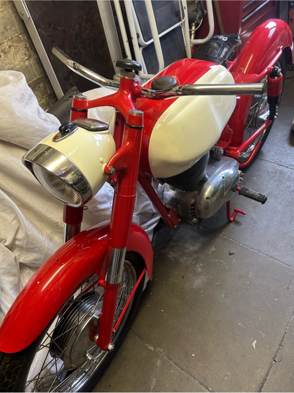

Photos of the rebuild so far

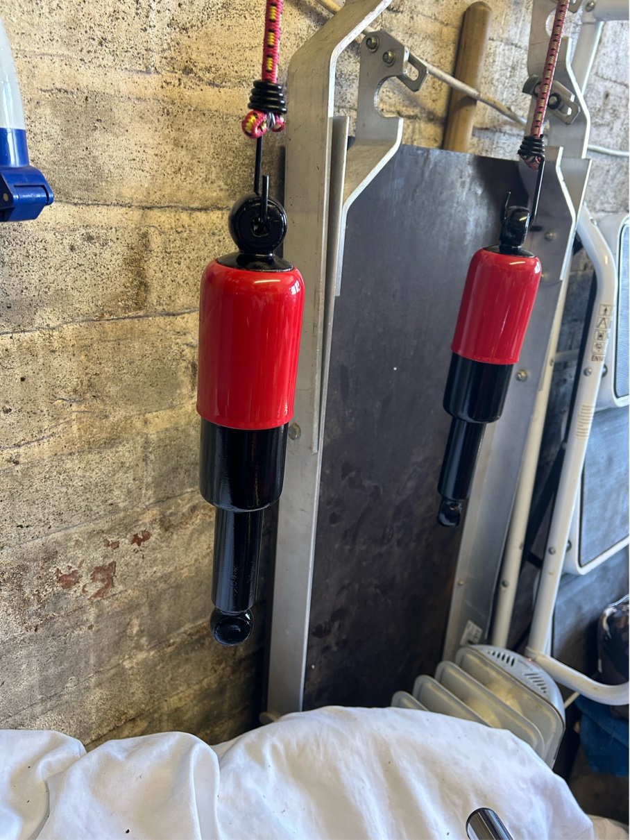

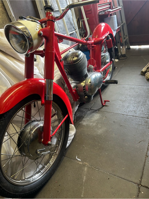

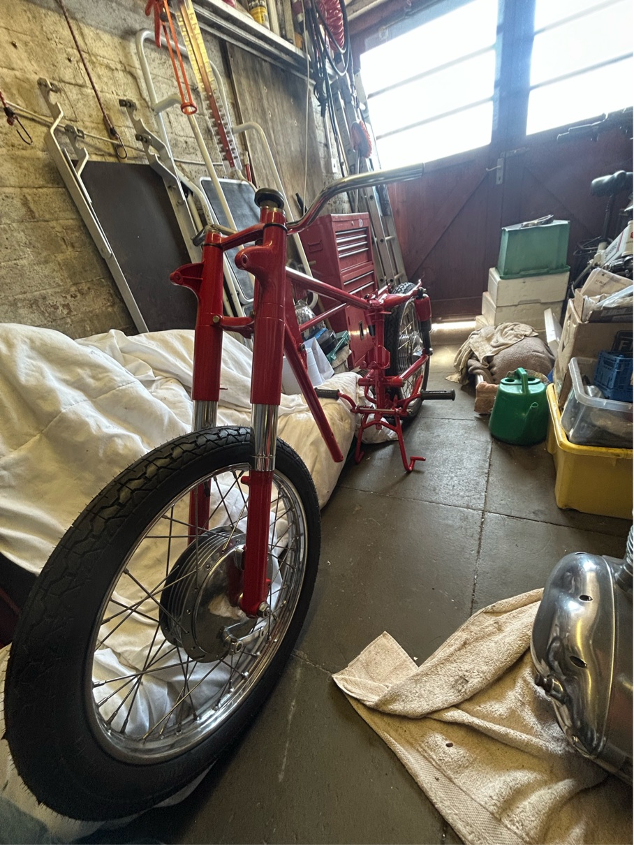

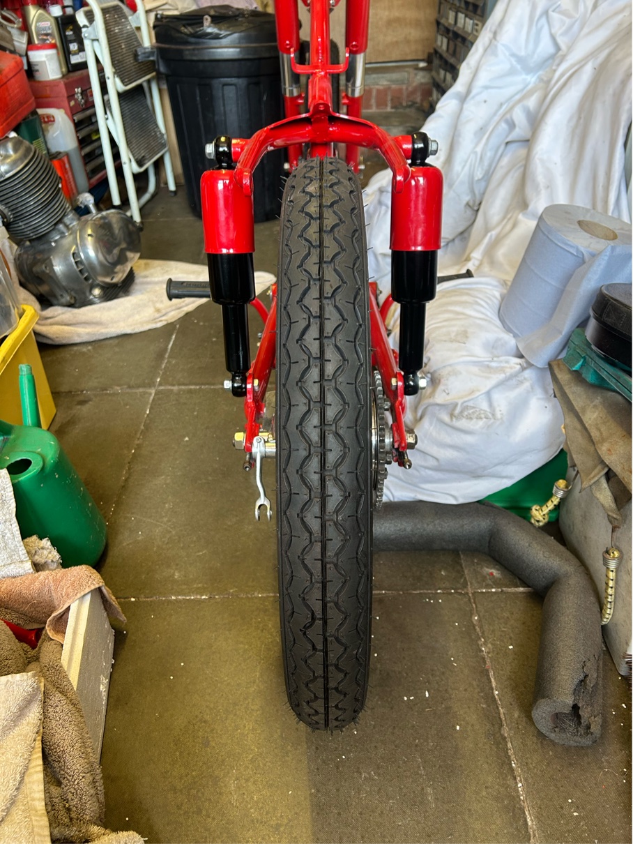

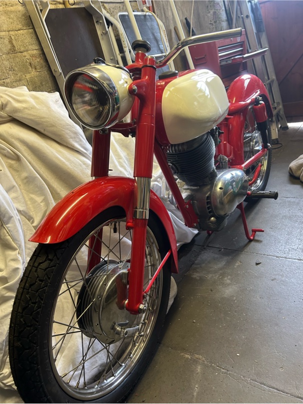

More picture of the rebuild

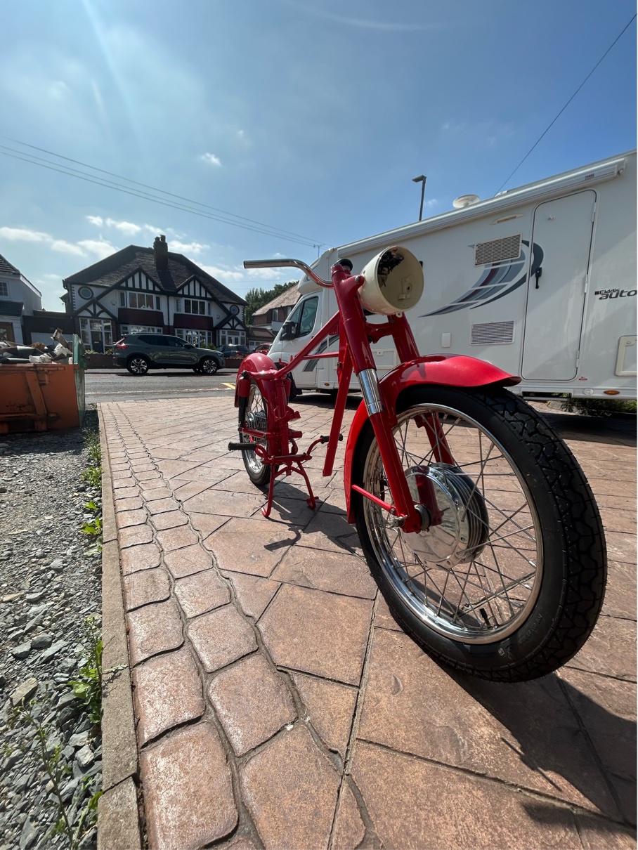

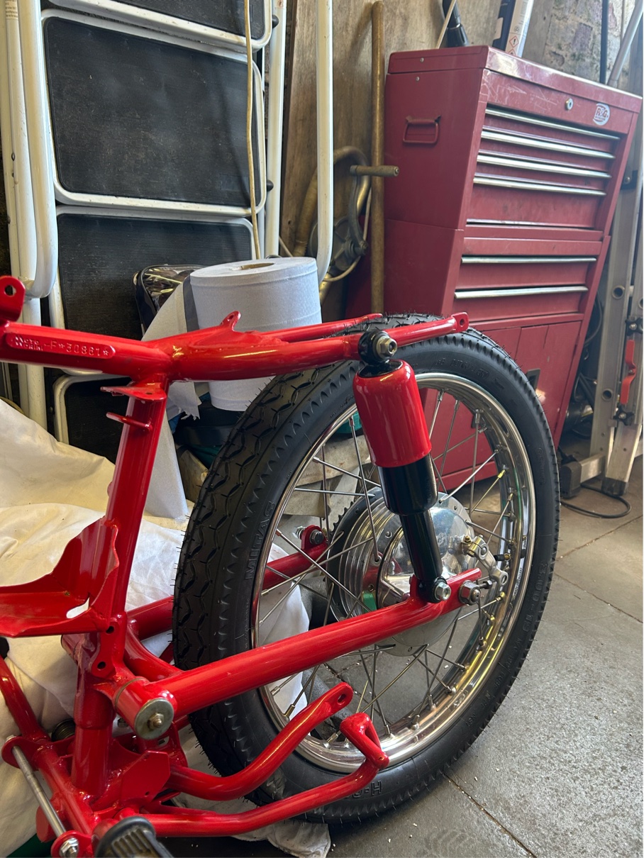

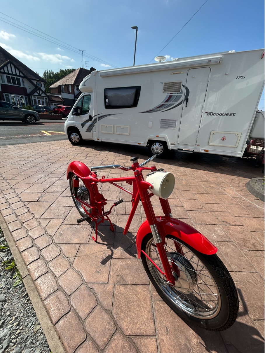

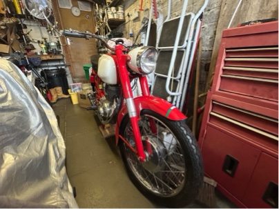

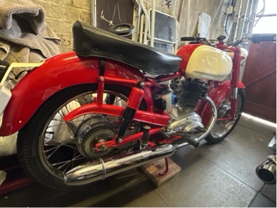

Last lot of pictures today
