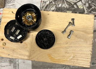

All my parts of old switch- fell on floor again upon prising off the bevelled collar. 0/10
6 pole switch
6 pole switch
Posts: 1469
Re: New Strada owner - hello & a switchgear question
If you turn the wavy plate so the pin aligns with a hole on the case it can be extracted. Pulling off this plate allows a pair of ballbearings to fall out. I caught them.

Ah thanks John - appreciate that.
Mine is a slightly different construction - but really useful info nonetheless. There's no wavy plate in mine, looks like the 'indexing' perhaps relies instead on ball bearings (or something else) being pressed in and out of the grooves in the metal casing of the switch body itself - which all makes sense now.
The design on mine looks like there should be three little spring loaded ball bearings or 'locators' for want of a better word that slide on and out of the index grooves for the three key positions. I have the three springs, but never spotted any ball-bearings whatsoever. Either I missed them (not at all unlikely) or whoever was in there last left some or all of them out.
