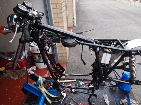

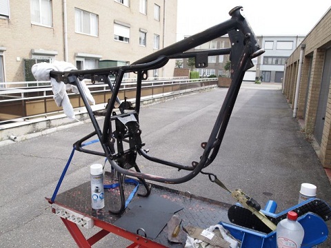

So i stripped the bike
Painted the frame with epoxy-paint
and refitted electrics

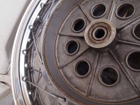

They serviced the drumbrake.

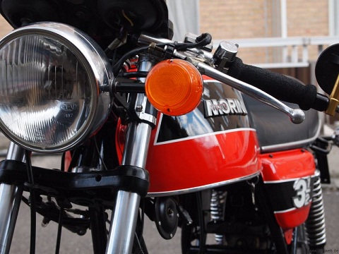

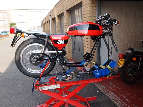

bought another tank and painted it
Someone did the striping (by hand)
Ready to refit the engine

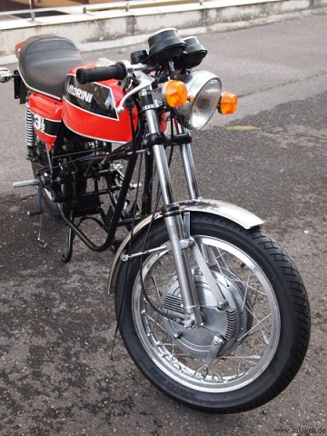

Almost finished
