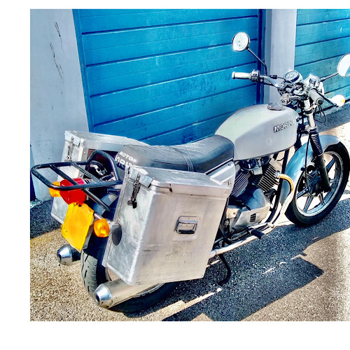

I made a pair of panniers by cutting a ‘Grundybin’ kitchen box in half!

Thanks George. They’re made of scrap materials I found in skips.... except for rivets, silicon, latches and some craven qd mountings. The size was dictated by the original box and position allows for a pillion. I mounted the indicators on a bit of steel tube I found.
The box was conveniently pre-distressed!
