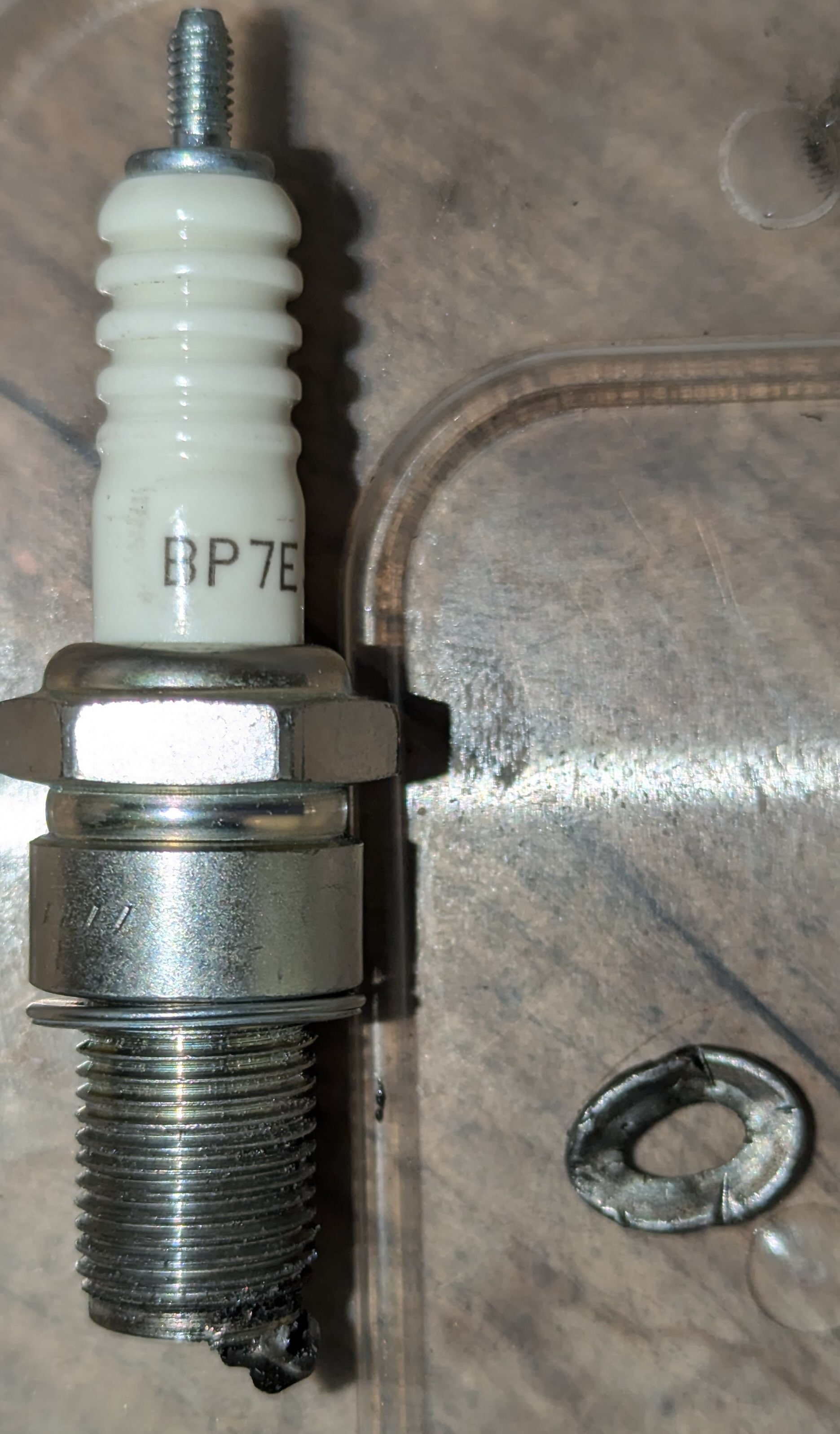

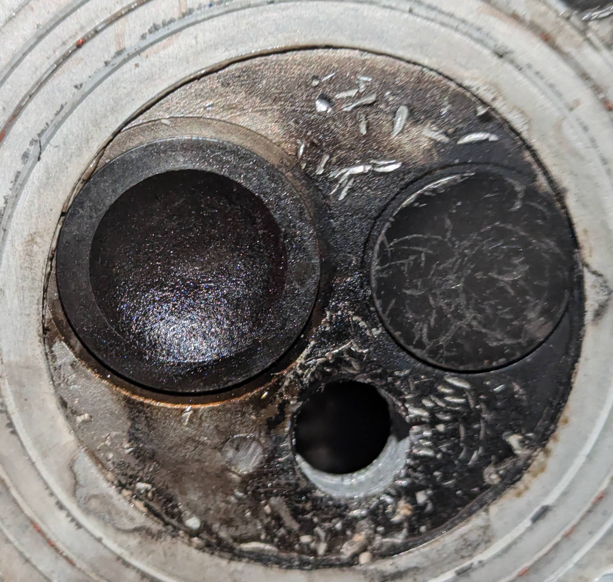

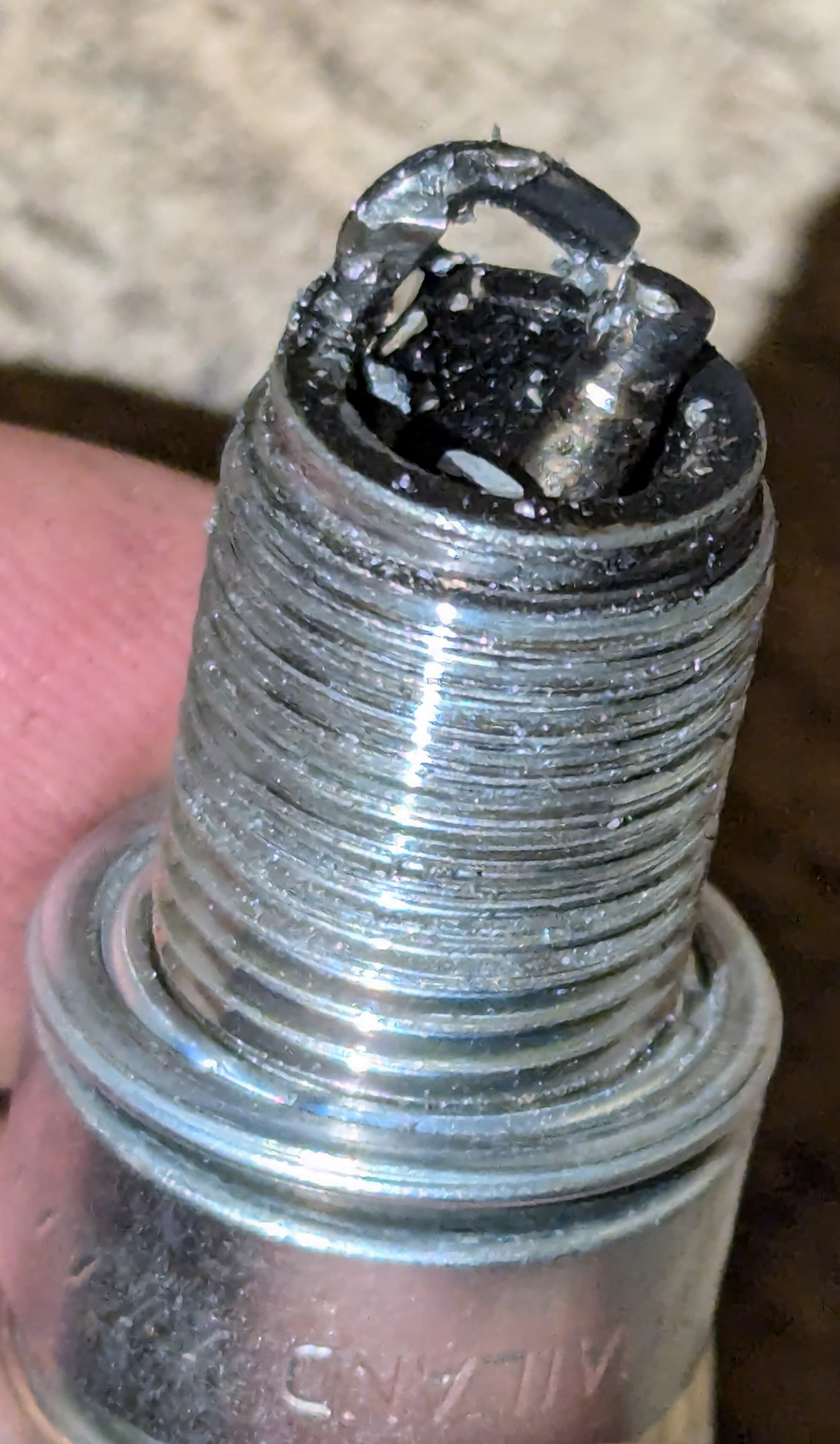

I've made progress with investigating the cause of the clatter and the engine not turning over. In short, it seems an M6 flat washer stopped play inside the rear cylinder. The spark plug was badly damaged and unfortunately removing the spark plug from the head before I removed the cylinder head stripped most of the spark plug thread. There's superficial markings on the head near the spark plug.
Any guesses which washer this was (I think it's a Morini one as I generally use stainless steel ones? and where the washer came from? (I don't think it's from the M6 cap head bolt that holds the cylinder head in place, at least that one was still on the cap head when I removed the head.)
I've searched the forum and I can't see any posts about rethreading the spark plug thread. Any recommendations are most welcome.

My planned next steps include:
  • Cleaning up inside the rear cylinder to remove the aluminium and any other remaining debris. It's mainly aluminium threads from the spark plug hole.
  • Check the rear piston for any signs of significant damage.
  • Remove the valves and investigate in case they or the inlet/exhaust ports provide any clues about the washer's journey before it ended up in the combustion chamber.
  • Clean up the cylinder head generally and materially if recommended to do so.
  • See if I can track down where the errant washer came from.
  • Find a good way to repair the spark plug thread and get it done either by someone else or myself.
  • Hopefully, reassemble and check compression of the front and rear cylinder before test riding it (with a new spark plug for the rear, of course).

Posts: 2729
Re: One step forward, then a brief clatter and the engine stopped
Ouch.
Careful when you remove the barrel in case any swarf is dragged down the bore. Might be worth oiling around the piston.
You probably need a helicoil or similar. This will require a drill to be at the exact angle. I would not attempt it. Look in the classic bike mags for people who can do it. Might be worth checking the other head, too.
The washer must have been in the cylinder when you rebuilt the engine, I doubt it would have come through the inlet port, unless it dropped in from the inlet manifold before you started the engine. The only washer close enough that thickness would be in the pushrod tunnel but that would go on after the head was attached. I think you would have noticed an errant washer on the piston crown.

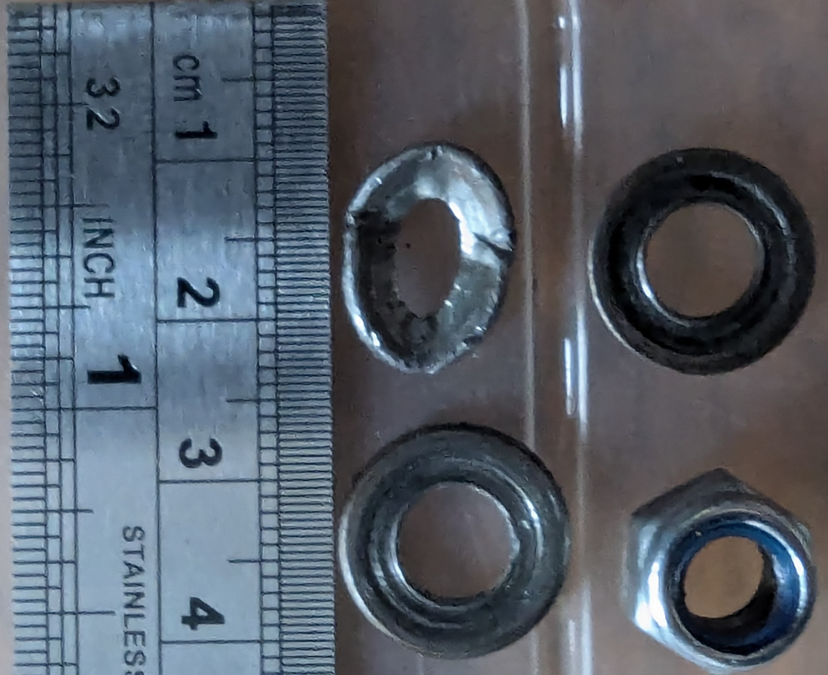

Are you sure its an M6 and not perhaps an errant M7 from the rocker studs? These washers seem to have a bevelled edge and are generally a little thicker than standard form washers.

In terms of the source of the washer. I agree the two most likely sources are when I was fitting washers to either the M7 rocker block or the M6 cap head bolt for the pushrod holes. I did faff around with various lengths of the M6 cap head bolt (30, 35, 40 mm thread lengths) as the old ones weren't to hand; and I might well have tried 2 washers on the 40mm thread length. Any of this work though would have been when the head was on the barrel, either before the head was bolted down or afterwards. I probably fitted the spark plugs after the rockers were fitted but can't remember the details. So there's the potential for the washer to have entered via the spark plug hole.
However if the washer entered when I assembled the engine why didn't it make an appearance earlier? I'd run the engine many times (at least 20 times) over the last few weeks, mainly in neutral outside the garage and only up to about 4k to 5k rpm with a temporary fuel tank and very brief 10 metre rides on the drive to see if the gears engaged, and to free the wet clutch. I fitted the airbox relatively late in the process; I'd split it to check the filter and to clean it. There are M6 flat washers used to hold the airbox to the frame but highly unlikely that they'd end up in the internal area of the air box in my view.
The clattering only happened after the test ride on the road and the damage looks consistent with infrequent contact with the head and valves. Also the bike was probably running on both cylinders (and the rear seemed the livelier of the two). The washer could have rested in one of the cutouts for the valve pockets in the piston but that seems unlikely that it would only free itself / move after the test ride when I restarted the bike on the drive.
I've taken some measurements of the damaged washer and the M7 rocker washers. I used a low cost but reasonably good micrometer, the rule is to help show scale on the photo. All measurements are approximate owing to the limitations of the measuring tools I used and my abilities in using them.
  • M7 rocker washers are: 14.2mm OD, 7.0mm ID, 1.4mm thick. Measured difference in radius 3.5 to 3.7mm.
  • Damaged washer's dimensions have mins and maxes because of the oval shape of it: OD max 14.3mm min 10.5mm, ID 4.1mm to 7.1mm, thickness varies between 1.3mm and 1.7mm, most of it is 1.4mm. Measured radius 3.3 to 3.4mm.
Visually the damaged washer has a different profile; as Mark observed the M7 rocker washers seem to have a bevelled edge, this washer doesn't have the same profile. I'm leaning to it being an M6 washer rather than one of the M7 rocker washers but not 100% confident in this assessment. I've found standard dimensions for M6 and M7 washers online e.g. M6 A2 OD = 12mm and M7 A2 OD = 14mm on the accu.co.uk website.
